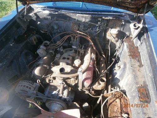

ya, to be honest I don't know what the orig. engine is.... the vin just says its a v8 but I have the fender tag and will take a look, it also says its a "taxi" does anybody happen to know what that means?
Maybe a 318 pol, a 361 or 383 big block, I would think.... #-o

Take a good look
http://www.forabodiesonly.com/mopar/attachment.php?attachmentid=1714739108&stc=1&d=1406292822
What you have in there is a mid 70's 318, identified by the heat stove on the driver side exhaust, and the EGR valve on the intake. The "style" of the oil breather is also of that later era. It of course has the later timing cover / water pump set up. Pretty sure that is not a 360, "estimating" by the bore of the intake barrels

okay, as I said my dad bought it with no engine and put in a cop car 440 and sold it as a roller and the guy I bought it from put this 318 in,

The vin is 6835164915 . when I went to check the vin it got me all confused, I guess earlier cars have numbers.
I decoded the vin and all it said that it was a v8 taxi 1963 polara built In California

I also decoded the fender tag to determine the car is a "taxi" price group dual manual mirrors 383 4brl car!!!!!!!
