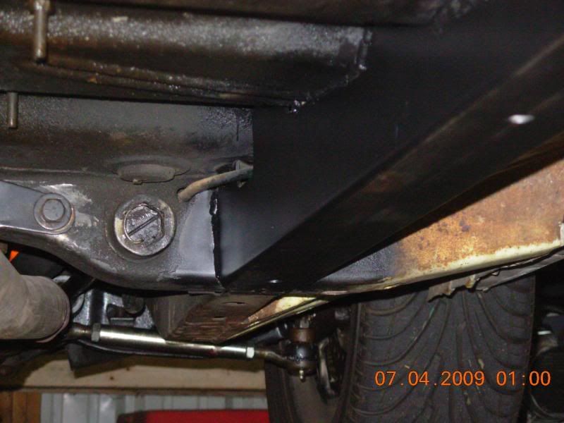

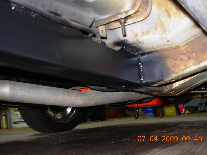

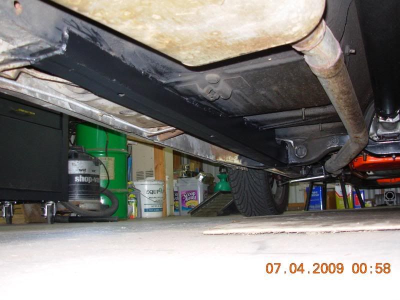

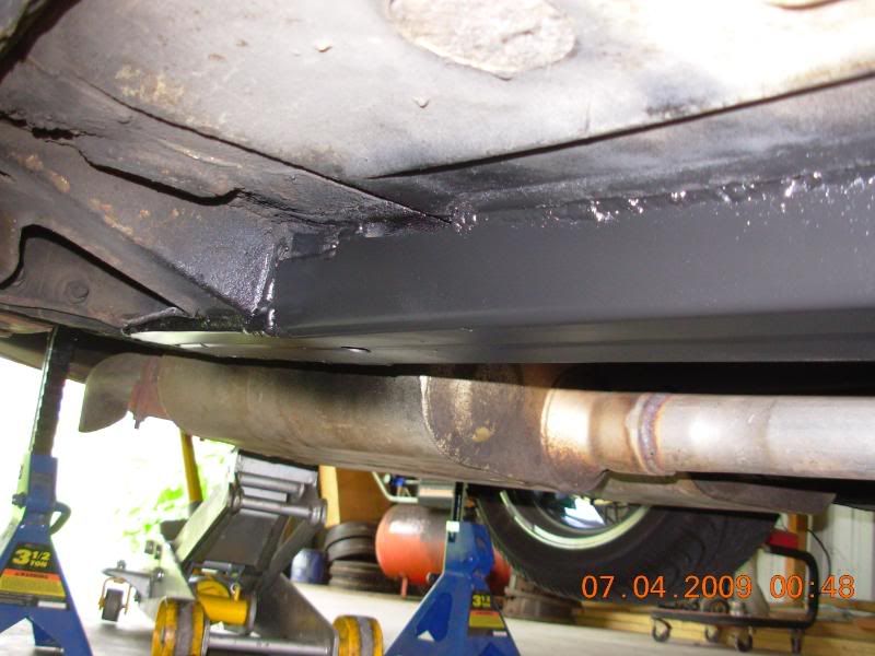

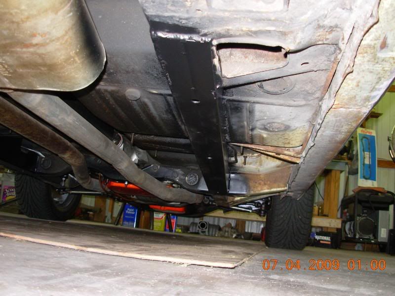

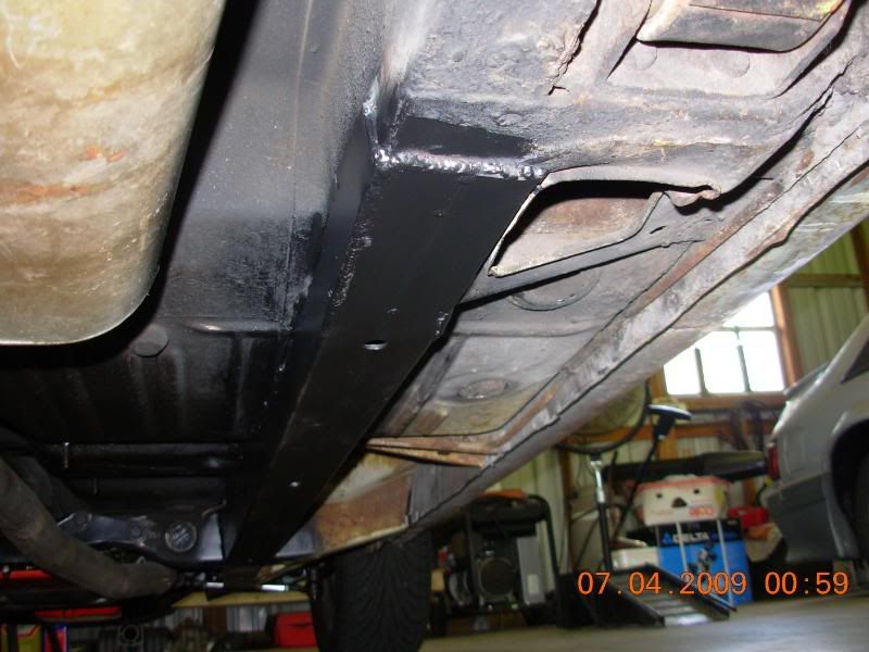

Well, the US car tool connectors are in.... Yea, it was more of a job fitting them than anything else. Once fitted, it took about 3 hours to weld in, after 3 hours or so of fitting. Of course this project will lead to another I didn't think I had. Found rust in the rear floor pans, not alot but needs attention.
You guys were right about the connectors, Wow, what a difference in the quality of the ride. I would swear it even ride quieter. Finished about 830 tonight so I didn't get much time to check it out but it sure felt better.

I did some of the prep work and fitting. I got tried of crawling under the car during the fitting process so I went to Pro Fab and got Matt to finish the install. The console and seats had to come out, the carpet is just pulled back. The issue of rust was a little tricky to weld, but Matt was able to get it done, although it took longer than I thought it would.

That is about it, the cutouts to fit the floorpan aren't that close, you have to do quite a bit of grinding and trimming to get them close enough to be able to get contact to weld. You will have to make notches for the fuel line and take care with the brake line. You have to keep in mind any future fixes that you might need to do with the brake and fuel lines. The emergency cable might need to be re-routed. I don't have e-brakes so it wasn't a concern to me. I like the product and I am sure a more talented person wouldn't have any issues. The truth is that if I had had a drive on lift or any lift, I could stand under there would not have been any issues. I am not as flexible as I once was so creeping under cars 18 inches off the ground just isn't that easy anymore. U S Car tool connectors, including shipping, were 192 dollars. I think they are worth it, I just wish I could have done these things when I was in my 30's. Now that I have a few extra bucks now and then I also have quite a quite few years pass 30 to go along with them.
