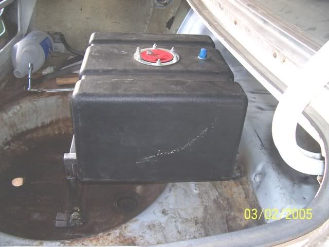

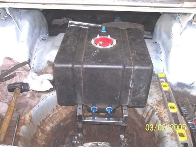

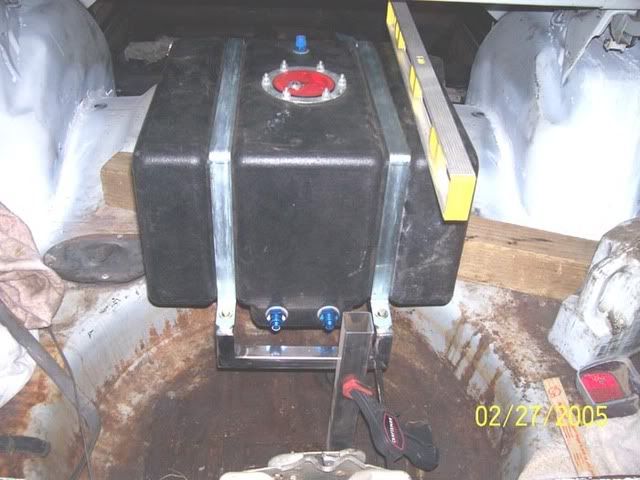

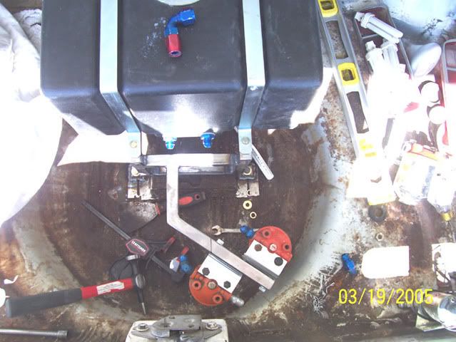

Mine is half in the trunk/ half out.
Has an angle iron cradle welded to the inner frame rails.
This was easier to mini tub the car with a big, square hole cut in the trunk, then made the cradle to bolt the cell to.
These pics are old and the trunk is finished much better now.
