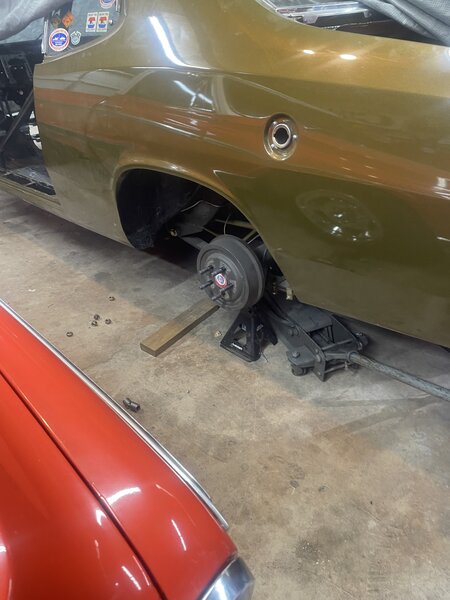

I'm working on building a nostalgia Prostock Demon and following the pre-1973 rules, which require factory rails. However, there’s no restriction on modifying them, so I’m aiming to stay accurate while also getting insights from people who've done it before. I’m curious if anyone here has attempted this, and how they approached it.

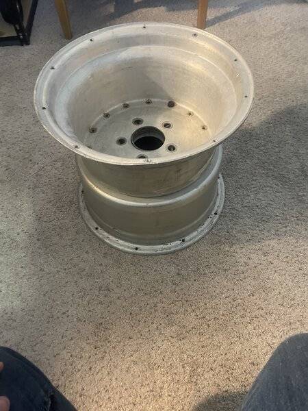

The goal is to achieve an 18-20" frame rail-to-outer-quarter dimension to fit a 32.5x14.5 tire, with a section width of 18" on 14" wide rims. I’m debating between narrowing the existing rails or getting new ones from AMD and moving them inboard by 2.5". I’d then use inboard spring pockets with sliders on the rear. Since it’s a leaf spring ladder bar setup, it adds another layer of complexity. I’ve attached a couple of photos of the Butch Leal A/MP car as an example for reference.
