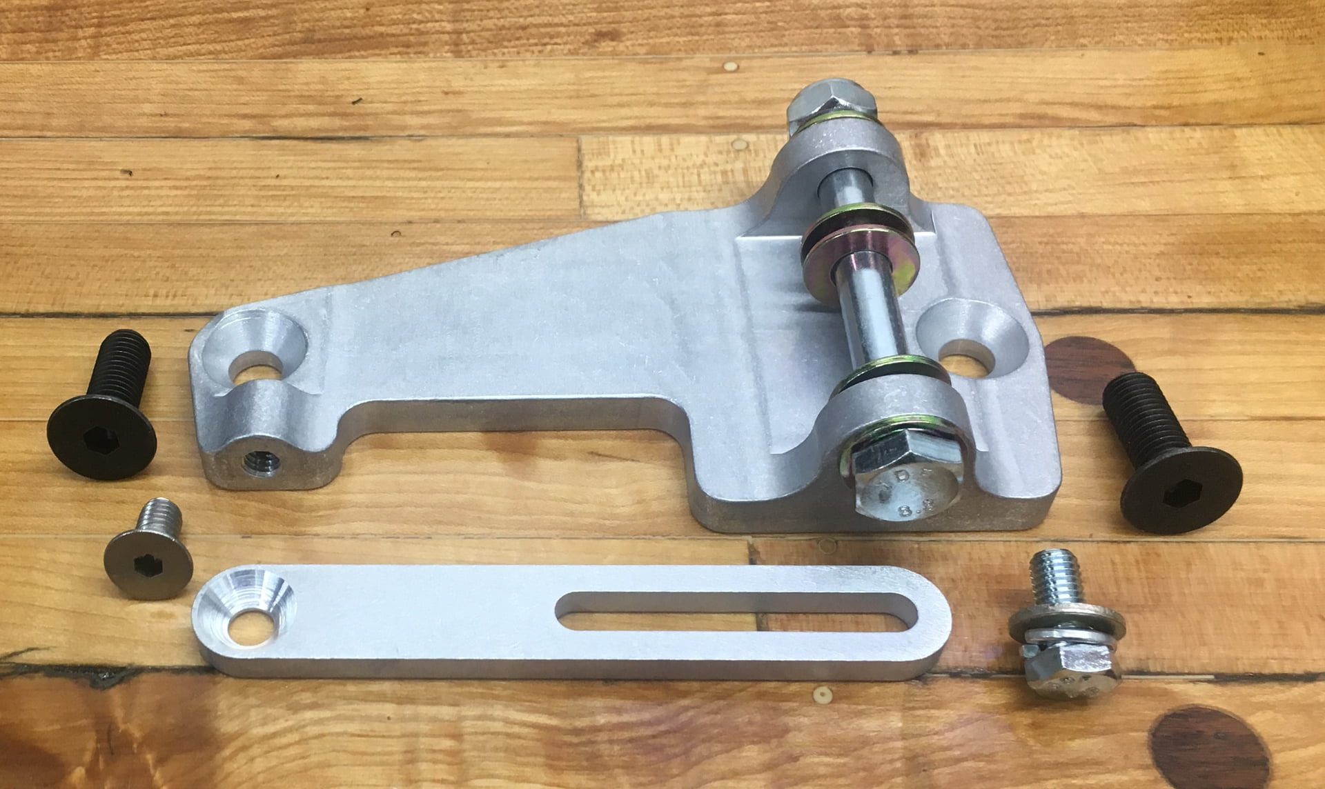

I can't find this mount anymore. It's like this company went out of business. Has anyone else mounted a mini denso without this bracket?
I found them on FB - AEICNC/Arch Process Integration | Mansfield OH
Looks like their website is NA but they list a phone number ((314) 435-3461) and it says they are open, so maybe call?
I also found this one, but no details. Might be similar?
