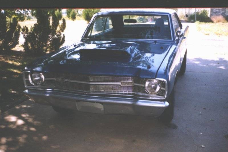

A couple of pictures in the dark at the track. The paint looks ok in distant shots in the dark ! 340 4 speed, one of my babies.
