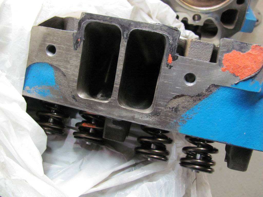

From the junk pile?
From one of the T/A heads.
Okay, now I'm starting to remember..........about 15 years ago.............there was this accident we built a new set of heads for.................
Hard to see, but in the last picture the guide boss tail is broken off. I suppose I could see if a new guide would fit tight......maybe someday.
Yes, they have been ported by someone, not us.
I've seen some f,ed stuff but don't think I have ever seen a valve bent like that!
I had that conversation with a member and was chided for saying the same thing. I was told the TA head outflowed other heads by 10-15 cfm having a different port... UMMMM NO!

Now I see, The rocker failed, the pin came out, the roller fell out, the rocker pushed the retainer down and the keepers fell off, the valve dropped and hit the piston. Or the spring broke and the whole thing fell apart. Yep that's it!
People sure change.
Port job looks like templet crap, Heavy *** valves.
