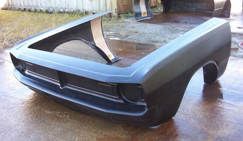

I am going with my son today to get my car trailer and the Race chassis Demon back home. He is going to finish the Chassis and cage the take it back. Then we are going to get the other 4 spd. Demon into the shop so I can start assembling it on a rotisserie for paint. I am going to take it to have it completely pre painted. So all I have to do is start adding all the factory pieces. My orange Duster that was wrecked will now be a Demon race car. The reason we went with the Demon nose is for room in front of the engine for future crank driven pro charger. We will take the other Demon and make one street car and one race car.
