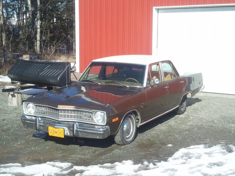

That's all good to know. The car is completely stock. It has a 318 and 75,000 miles. Never had a /6 in it. So im probably looking at new torsion bars? The steering in it is okay but maybe I could redo that as well. Is relpacing a torsion bar a big job? Its also got 195/75/14 tires on it.
So this is the car?
attachment.php
Doesn't appear to be lowered in the front, so, with 75k miles I'd guess that new torsion bars are probably in order. Didn't realize it was a 4 door, so, that would make it heavier than its 2 door counterparts too.
