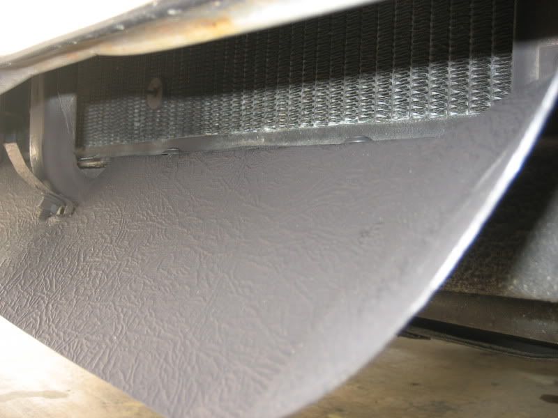

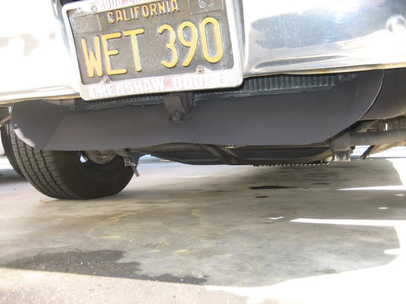

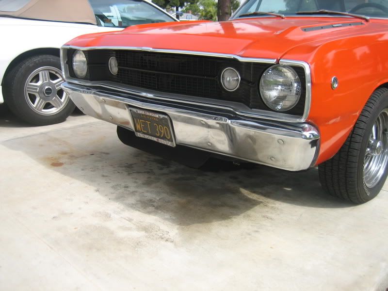

I made the "wing" for my Dart out of tin sheet material found at ACE Hardware. It is fastened to the Radiator Mounting with Four self-threading screws.
Here are a couple of pics :
Keep in mind that this is a "Function over Form" type wingnuttery, so while it ain't pretty, it works good...:-D

Another pic, this one a close-up of the "wing" Angle in respect to the Radiator:

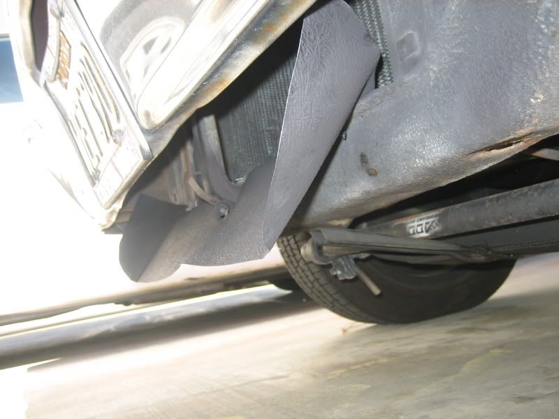

Here's another Shot..
