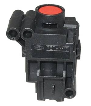

Why dont hi perfomance fuel pumps come with the built in safety circuitry?
an inertia switch will take care of the turning the pump off in the event of a crash. i have used one from a Ford in the past.....
