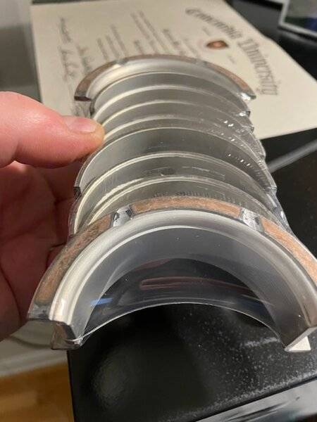

I ordered a set of fully grooved Mahle (Clevite) main bearings from Summit. First time I have ordered fully grooved main bearings. I was surprised to see that one of the thrust bearing halves was not fully grooved while all the other 4 journal bearing halves were fully grooved. I called Summit and they confirmed that that is how they come per the Mahle catalogue. It was not a mistake.
Do other manufacturers provide thrust bearings where both halves are fully grooved? I am curious.

Here is a picture but I have not opened the package. Not a great shot. The last bearing is the other half of the thrust bearing and is grooved. The first bearing in the photo is the i grooved thrust bearing half.

It's after 1975. Chrysler changed the thrust bearing to where they have what you would call a small thrust bearing an a large thrust bearing.
All 340s had the small thrust bearing. The 4 other bearings will fit they weren't changed. They did this on the 318 and the 360s also.
They are not the bearings he wants if he has a 340 block. Or a block earlier than 1975.
i run 1970 340 bl0cks , and use the 1344 mains always, had no fit problems. since 1977, just food for thought
