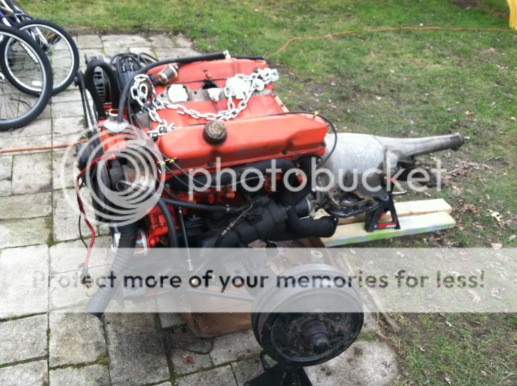

The Schumacher kit installed like a dream. Of course, it helped that I had the engine and cradle out of the car at the time. Headers, motor mounts and torque strap all installed and ready to go:

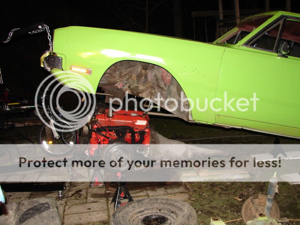

So the car got rolled up and set in place. I don't think the old girl knew what she was in for.
This evening after work the real fun began.
And just like that *SNAP* easy as pie.

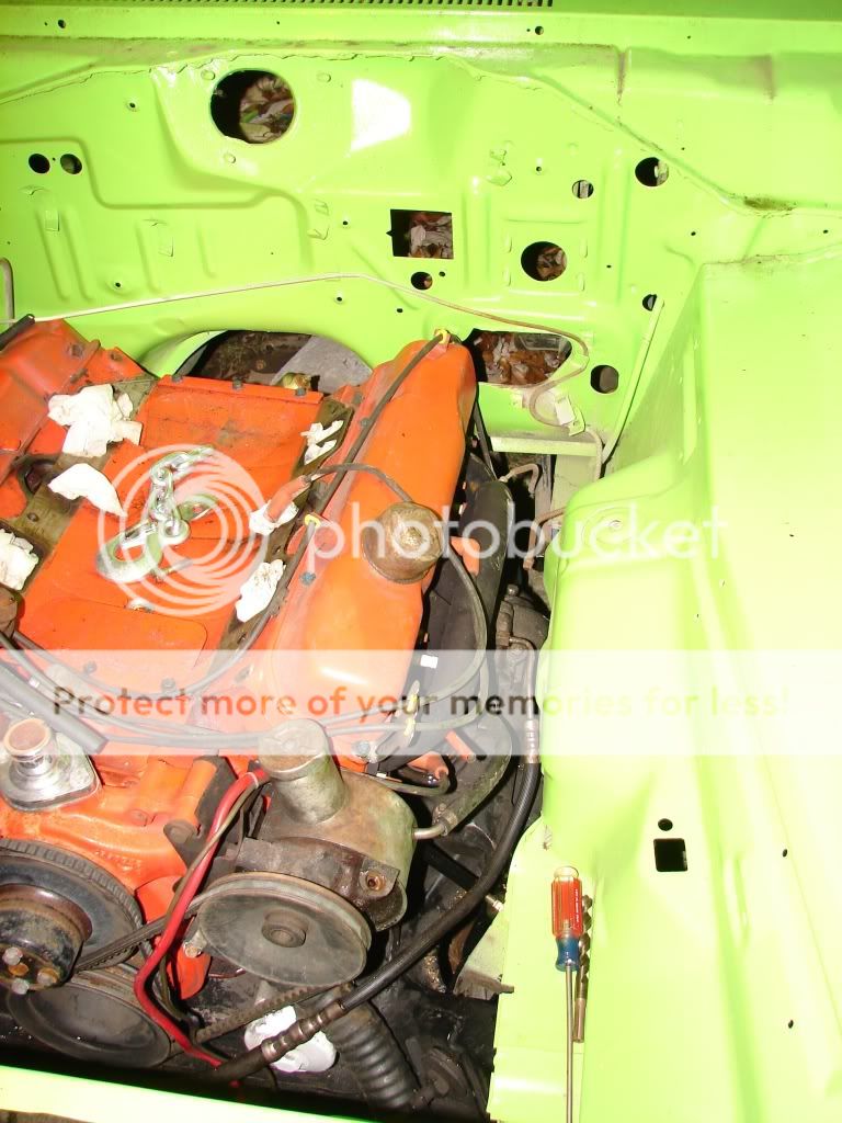

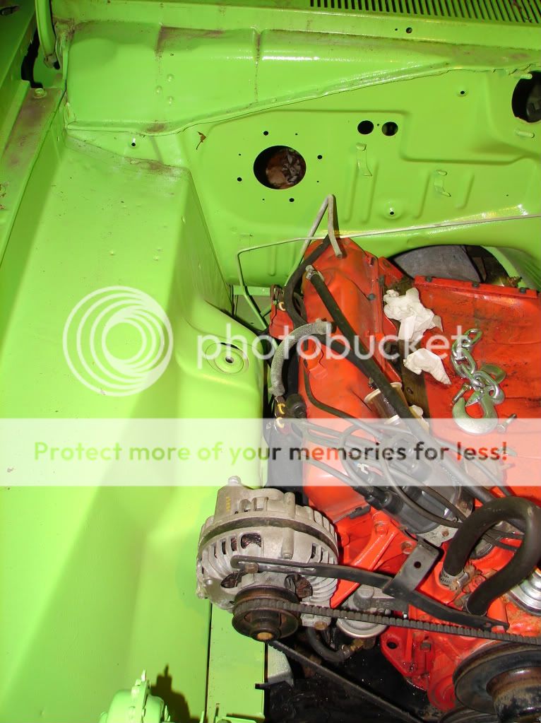

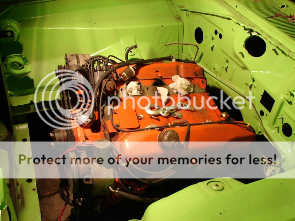

Plenty of room on the left.
Not so much on the right. But hey... these 440 thingies never need spark plugs changed anyway, right?

Shumacher puts the motor in the factory position. Great that it worked so easy for you! I think I just learned a lesson on how to put my 400 in. Heck the front of the car is way lighter than the drivetrain anyways!
I will definitly use your method. My garage floor is up hill from the street and any motor would need be pushed uphill and dropped in. At least this way I could raise the front of the car up and just slide the drivetrain under. I even have the equipment. Wheel dollies to slide the drivetrain on,cherry picker etc.
Yeah. I have to say, this was about ten million billion gazillion times easier than doing it the old fashioned way. Everything pre-assembled. Power steering, starter, bellhousing bolts, headers, motor mounts... Everything done out in the open. Just drop the car over the whole mess, slap in the four bolts for the cradle and the four for the trans cross member and presto. Granted I still have to put the torsion bars back in, but that's not exactly hard. Neither is connecting the brake lines and bleeding the brakes. I'll take that 99.99 days out of 100 over trying to do bellhousing bolts in the car.
Edit to add: Look at it this way. I installed an engine, trans, starter, power steering and headers in 3 hours. It only took me one beer and I didn't use a single swear word. My hands didn't even get dirty. :D

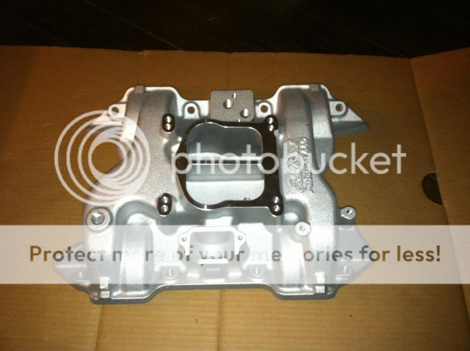

I know it's been a very, very, depressingly long time since I updated this thread, but the time has come. Since my last post, I got the Eddy intake installed, an Eddy 800CFM carb, got a big ol' aluminum radiator in, got the gas tank in, threw a battery in, got the dash mounted and test fired:
