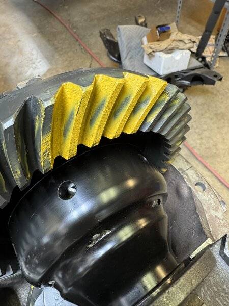

Setting up a 489 case with 3.55s. All the guts are new from Dr Diff. Motive gears. .032” pinion shim in there now. Should add a few thou?
no input on the pattern as i suck at it.. but am curious what carrier is that? the brand? have never seen one like that before..

yeah.. i had read up on that technology years ago, didn't know drdiffs added more gears.. am curious how they hold up to bigger power? i will never make real power.. but am wondering.

Hopefully, it will handle 400 HP ok. Just a guesstimate of where I might be on my 340. Mainly a cruiser, but I will take it to the track just to see. Would happy enough 12.90s.:)
