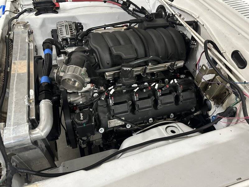

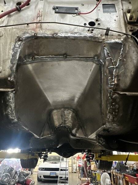

I am having this swap done now. A 392 into a 64 Dart. I went with the QA1 front coil over suspension with their new k frame kit. Orig 4 speed car, now with a TKX 5 speed, hydraulic clutch. The kit has most everything except brakes. Getting rid of the original torsion bars and steering components frees up some space but still a really tight fit. Exhaust manifolds need to be log type. We want with steel so we could easily cut and weld it as needed. Needed to cut the shock tower off on the pass side. PS pump needs a pressure reducer and the alternator needed relocation to the upper pass side, where the original slant 6 one was located.
The trans tunnel was cut out for the TKX and shifter location remade in the floor. Almost done.
What an awesome swap and will be Wicked when finished. Very clean and like a glove.
Looks like it belongs there. My 68 Cuda is a GENII with Altercation front suspension.
Coil Overs, Power Rack and Pinion, and NO Torsion Bars. Really opens that area up.
