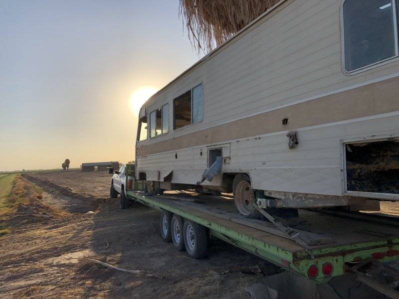

Got another moho 440 and working on getting another ‘68 truck to stick it in.
