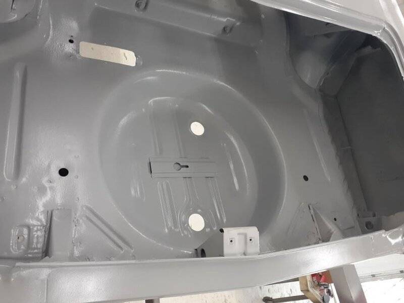

Ken's made some nice progress with the Notch. After tracking down the sheet metal, Ken's been cutting away and patching.
The rotted well is out and the new one is in!

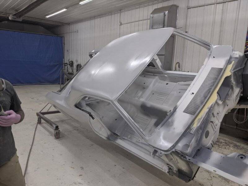

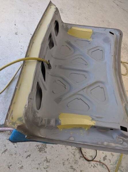

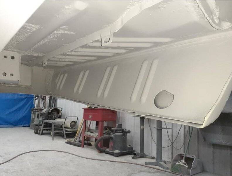

More progress the past week or so. Here are some shots of the Notch with high build epoxy. Mike says, "this is going to seal the whole body up and give us some material to block."

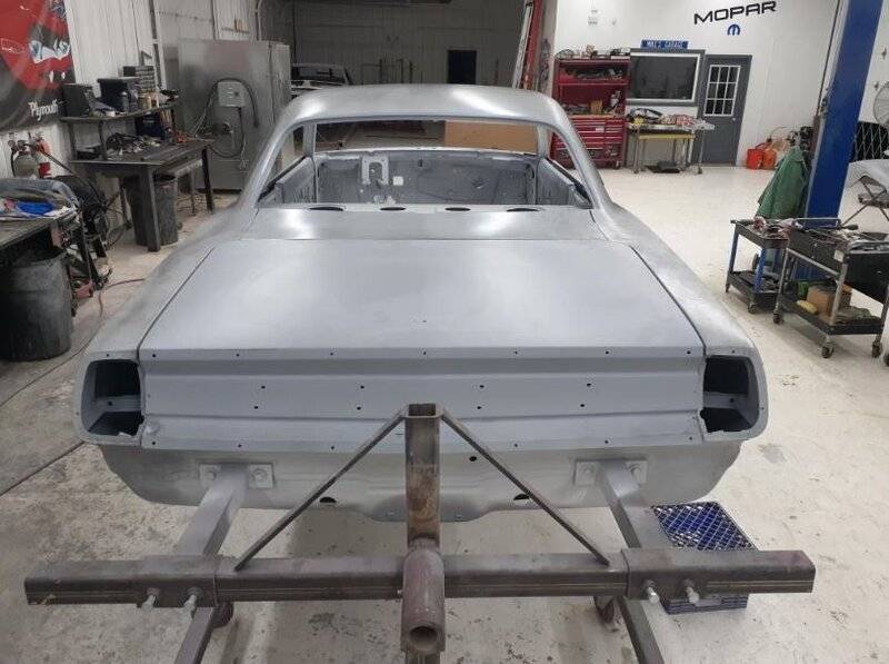

The trunk looks great! Since I'm staying with the original color of white, these pictures give me glimpses of how she's gonna look. We're still a ways from final paint! :-D
Here's a shot of trunk extensions:
Trunk underside:
Mike's keeping me up-to-date with their progress and I'll loop you all in too! More soon...
