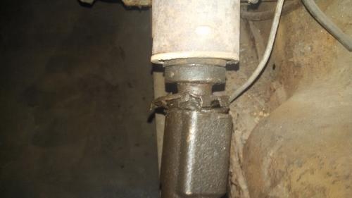

[WANTED] Good used plastic lower steering column bearing
There is a old thread here about a all steel insert type bearing that fits right in and can be purchased new through Amazon for around 7 bucks.
Thanks guys for getting back so quickly. SSBA I'll definitely take one that is used if it's not crushed or damaged. Actually I'll buy two if they are priced right. Redfish I'll also definitely look into the Amazon upgrade thanks. I'm trying to go factory correct looking if I can that's why I wanted to replace with the original part.

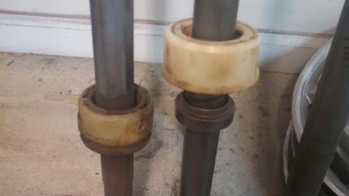

I have wondered why they used that style for only one year. I was lucky, I found a 68 shaft. Several people make bushing for 68-69 columns. LOL
67 is different than 68 and 69. Larger dia. and has a steel collar and spring.
67 on the right and 68 & 69 on the left in picture I posted above.
They would require a different bearing as the tubes are a different size.
You need to know what year column you have to get the correct size bearing
