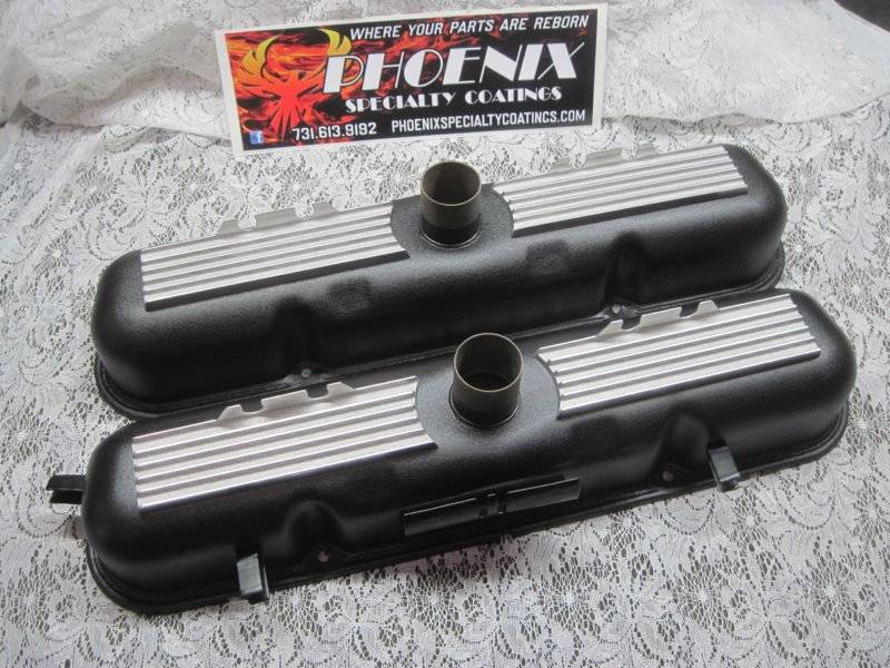

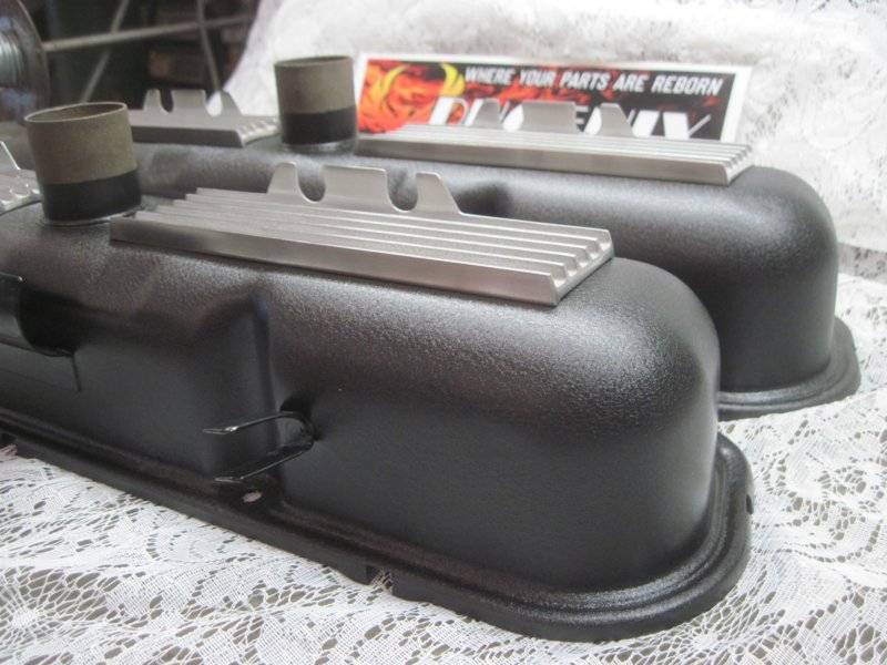

It will protect and preserve the polishing without hazing, getting dull or turning yellow over time. You all know what I do for a living, and this stuff is far and away superior to ANY clear powder I've ever used on my polished pieces (I no longer powder coat them at all). Check out the lower windshield trim for a convertible below, and the fins on the Commando valve covers for the famed Golden Commando GoldFish.

I've used it on probably twenty sets of Commando fins (@ 4 a set), a few pieces for Billy's projects, and every piece I've polished for probably a year and I'm still on my 4 oz. trial size. A little bit goes a lonnnnnng way. It will never need to be touched up (unless you get a curb rash or damage down to bare metal) and is supposed to last a lifetime. Every customer whose parts I've used it on has been delighted.
