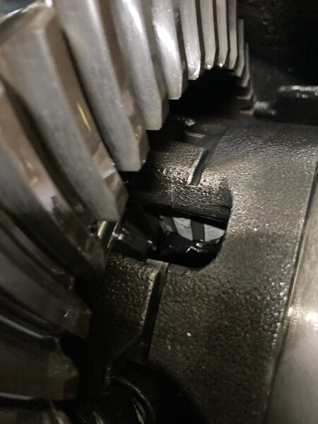

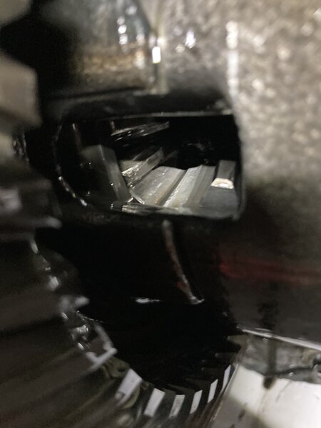

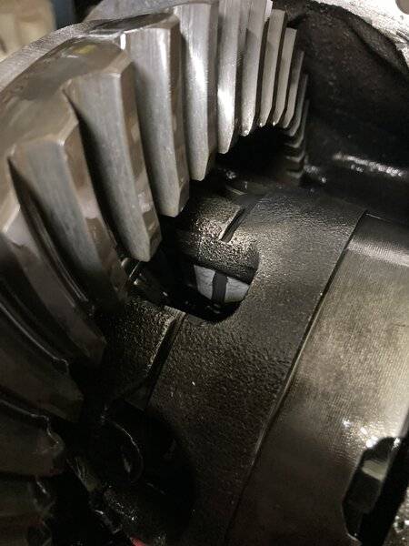

Guess what broke...... Centerforce Dual Friction + slicks

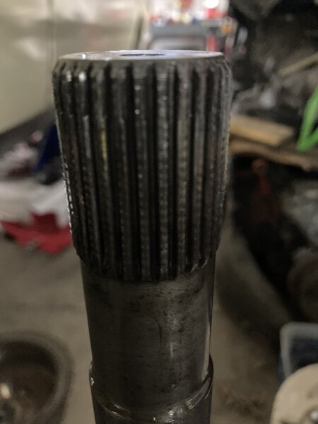

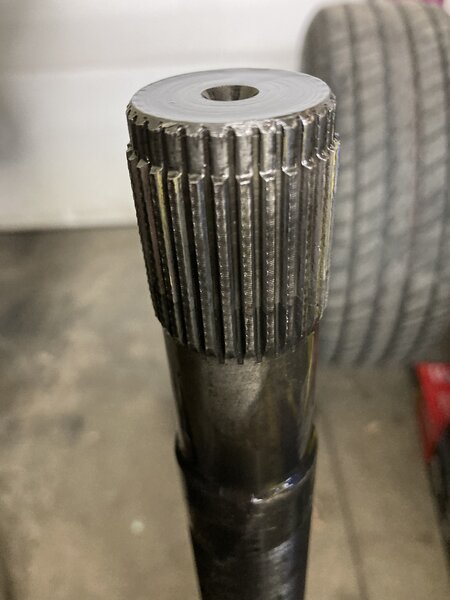

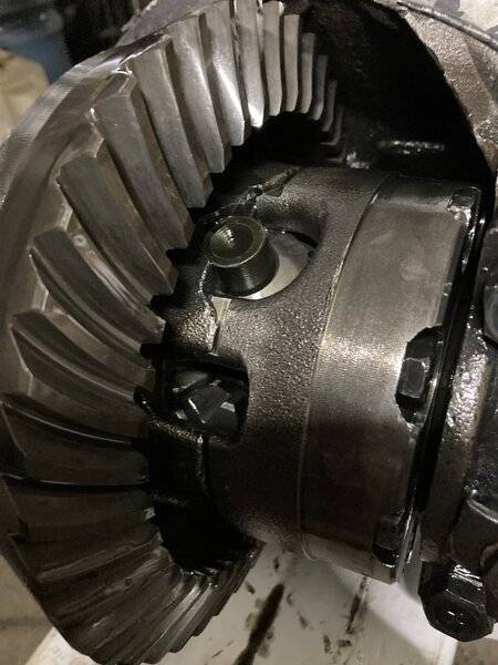

Looks like I’ve got a couple different issues. The end of the axle spline has been messed up for years. Not sure what I screwed up replacing the axle bearing and seal.
I don't have any experience with this setup. Is that the normal amount of spline engagement on the axle that spun?
That was what would transfer power, there's more spline but it's on the locker side & when the spline fails the locker can't take all the power....
Which is why it was redesigned with one piece side gears... The full spline transfers the power

Are you saying that the end of the axle that is stripped was messed up before this incident and not a factor?
Whether he thinks so or not, it's a factor.... It may have had previous damage, but if so it was hanging on by a thread....
Correct, happened 15+ years ago and I just swapped out for the single spline side gears.

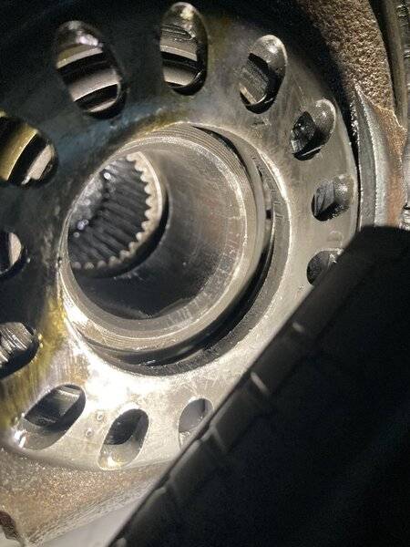

Looks like the suregrip/powerlock came apart.
I either didn’t install the seal deep enough in the housing or didn’t press the bearing on far enough.

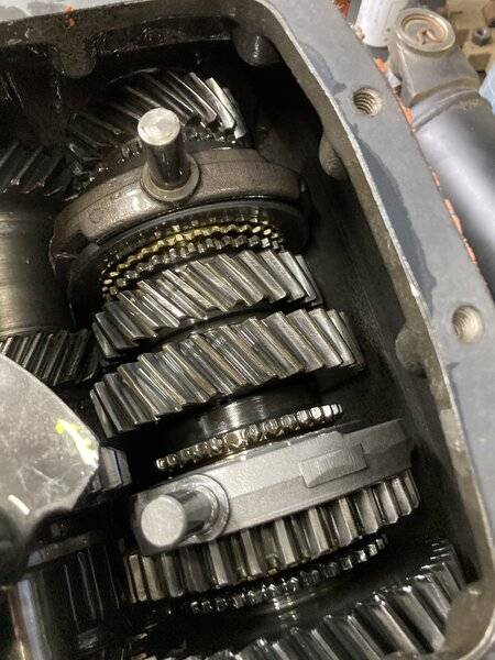

It's 99% street car, pulled the trans because I plan on changing the clutch. If I ever run the slicks again I'll have a clutch tamer.
Ram recommended this one.

I've never driven a vehicle with a borg beck style 3 finger but I drive the car a lot and would rather not have a harder pedal. I'm kinda kicking myself for installing the 2 step and the slicks.
You just need a little controlled slip. A clutch tamer would work great on it.
The reason I ask, I have three NOS Borg Beck and Long PP's. I am NOT trying to sell you something. Just putting it out there.
The Borg Beck Long PP has a lower pedal pressure than the standard 3 finger Borg and Beck due to its longer fingers. Pedal pressure is somewhere between a diaphragm and Borg and Beck.
I am not a fan of the feel of a diaphragm pp, feels like stepping on a banana peel, to me. I am aware I am not with the majority here. I also didn't find clean dissengagement at higher rpm.
You probably dont have enough spline engagement either. As in, axles may be to short
