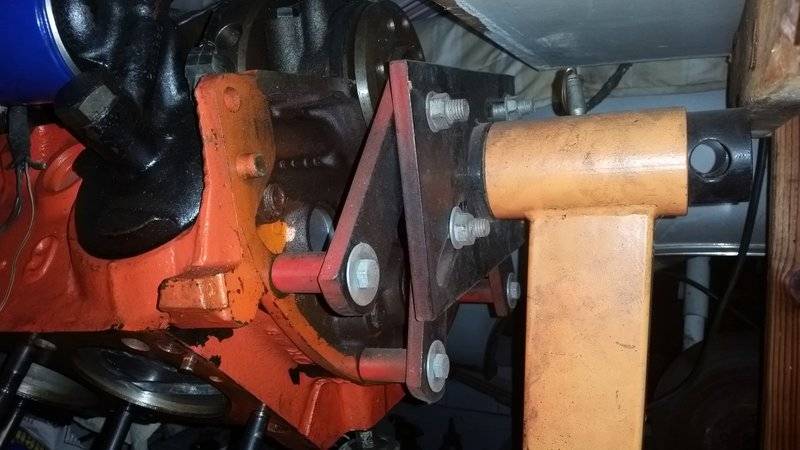

Bought a HF 1000 lb engine stand yesterday...installed 360 block on it....flip the head over so the horizontal slots are on the bottom...and the diagonal slots are on the top...
I also used the two bottom bolt holes on the block...used a bolt with a nut...

I must be doing something wrong or i am Jinxed. Could i burden someone and ask for a picture of their small block on one of these 1000# Stands?
Booya! Dont let it swing over when you are turning it as its rather top heavy but I uses it like this.

Ill try that. I have had this for years like that but.....Maybe I never thought of flipping it! Duh.
