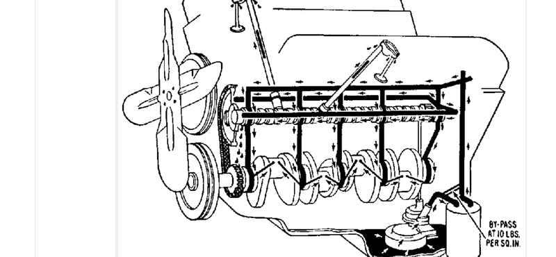

hard or soft copper line for a valley oil gallery bypass line?

Number one main is the supply to all the drivers side lifter bores. Those bores leak.
We are in total agreement on that.
We have to cut or stop those lifter leaks.
But Sanborn explains that the main problem
Is the design of the sbm tries to feed those
Lifters from #1 main. Number 1 main is at the very end of the passenger galley. You might as well say that the end of the galley has a great big leak. With a hv pump and high pressure relief spring and a big leak=
big speed in that galley as the pump tries to keep up. That is the root of the problem.
Whether you bush the block, tube the block,
or set screw and crossover the block, all three methods have the same goal to stop the leaks at the lifters and stop supply to the lifters from number one main so that main gets proper volume and pressure. The other main bearings are also helped as well.
Front oiling helps that problem even more.
Did you not notice that Sanborn used bushed
Lifter bores. I am sure they were restricted
Because of the pushrod oiling. So why did he need a crossover if he bushed those bores.
Why not feed that restricted galley from number one main. Think about that.
He already had a supply to the drivers side.
His lifter were bushed. Why a crossover.
He does not even reverse feed number one.
One of his pictures shows where he puts in the plug to block flow from number one.
Because number one main is where all the
Oiling issues begin. You think two columns of oil can’t flow, but you also think a long galley
With a big leak on the end doesn’t flow like crazy(velocity) either. It has to, to try to keep up with those 10 leaks. Look at the Chevy. One galley of oil right from the pump and filter to the cam and main bearings. The lifters are fed from their own galley. That’s what we are trying to do in the sbm.
Dedicate the passenger galley as main bearing supply only.All the galleys in the chev are sealed at the end. The Mopar is not. That is why the blocking of #1 main is way more important than the tube.

The Chev drawing with its 3 plugged galleys
Should make you be able to see the difference.

Why do you think Chrysler designed front oiling bosses right into the casting of the “X”
and “R” blocks if they thought it was not beneficial. The guy made you a simple drawing which is representative of the small block and asked you to explain why you are saying two columns of oil won’t flow. And you answer him with an insult. We had this discussion over 2-3 years ago and Rapid Robert was part of that discussion back then.
He had decided for his own reasons to perform that modification.
