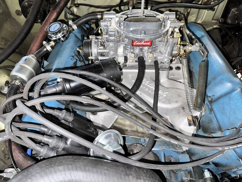

I do think you may be on to something do you happen to have a picture of what ported advanced looks like?
It should be hooked up to ported vacuum. Some use full vacuum but that is for far more built engines.
Based on this picture without being at home I can tell you ours is hooked up to the center and the left nipple

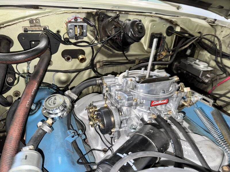

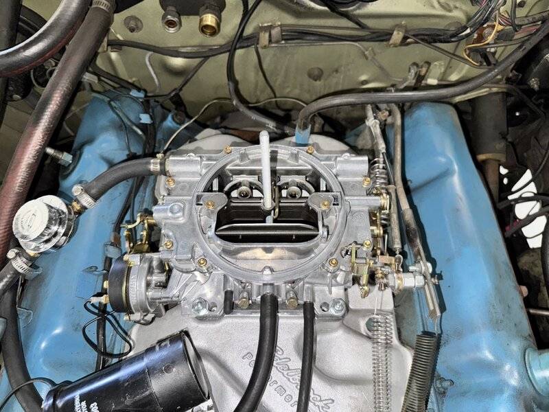

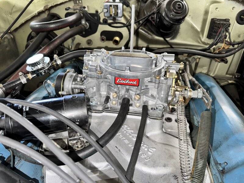

Looking at your pics, you have the vacuum line hooked to full manifold vacuum, move it over to the line to the left(looking at the front of the carb) of the pcv hose and plug off the line you just took it off of. Like @dano said, you should be on ported vacuum, not full manifold.
It was on the left side I moved it over to the right side should I move it back to the left side?
The instructions on this carb does say that the left port is for emission controlled cars however this car isnt emission controlled.
I would move it back yes. Dont worry about what the instructions say about emissions, you want it on ported vacuum, go back and read post #26. Then I would get your hands on a timing light and vacuum gauge and post some actual numbers of what your motor is doing. There are members here far more knowledgeable than me who can help you more seeing some actual numbers.
