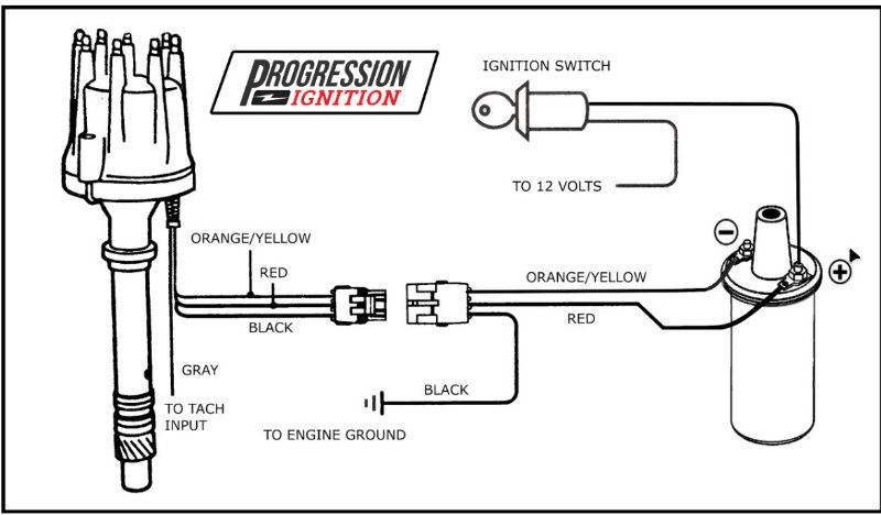

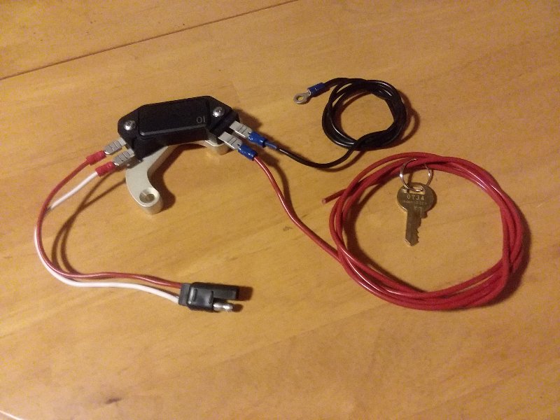

I installed a progressive ignition Bluetooth distributor.
OK it's important we know this, and I didn't realize
Is this here what you have?
If it will start with power jumped as the diagram shows, AKA coil + then this should be simple

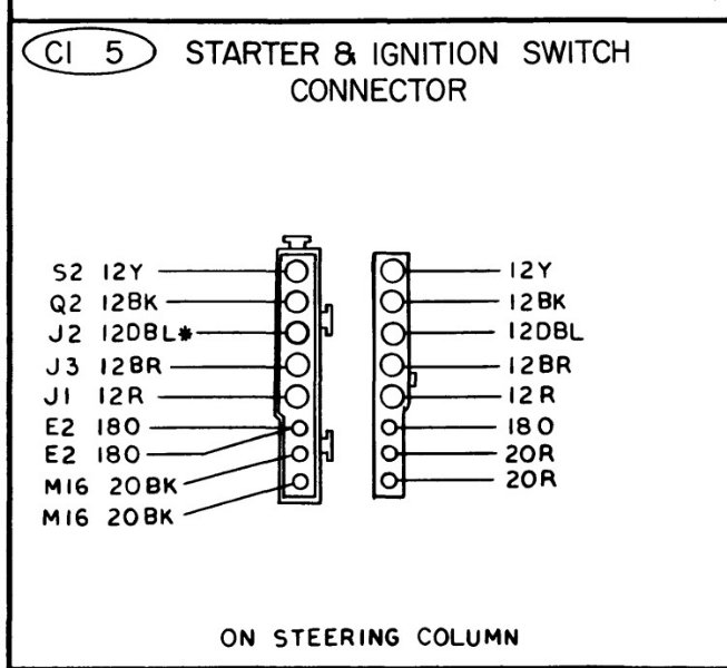

All you need to do is start at the key switch, look up the ORIGINAL car wiring diagram and identify the switch connections, then REGARDLESS of whatever color wire is used, trace the IGN1 and IGN2 out through the bulkhead wherever they go. They are also going to have to be connected to whatever is under the hood that needs "run" power, AKA VR power, alternator field, choke if used, and of course ignition system, and that means the coil +
If you do not have one by now, run over to MyMopar.com and download the two volumes for the 73 service manual. I believe it is Dodge.
This is the switch connector, right out of the 73 manual
S2-12Y is the yellow start wire, goes out through the bulkhead to the start relay one of two "push on" terminals
Q2-12BK is the ACC power is hot in ACC or "run"
J2-12DBL is the Dark BLue "run" wire, hot ONLY in run
J3-12BR is the BRown bypass wire.
(The above two you need to trace out into the engine bay and hook them together, and hook to the coil +. J3 is hot in "start" ONLY)
J1-12R is the Red hot feed providing power TO the switch
E2-18O is Orange dimmer controlled lighting for the shift quadrant
The bottom two, small Black, are for the "key in" buzzer and lighting
You are kinda on your own from here, as I have no idea what has been done with wire routing or wire colors between the ignition switch and the bay. I also have no idea what was done with the bulkhead connector, or what condition the terminals might be in.
And TEST this AT THE KEY SWITCH, because it is possible that it is screwed up internally. Take your meter/ lamp, and see if the "run" is hot in run, and if the brown bypass is hot in "start." Then trace from there.

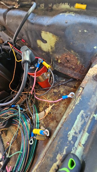

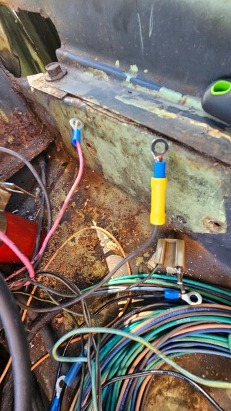

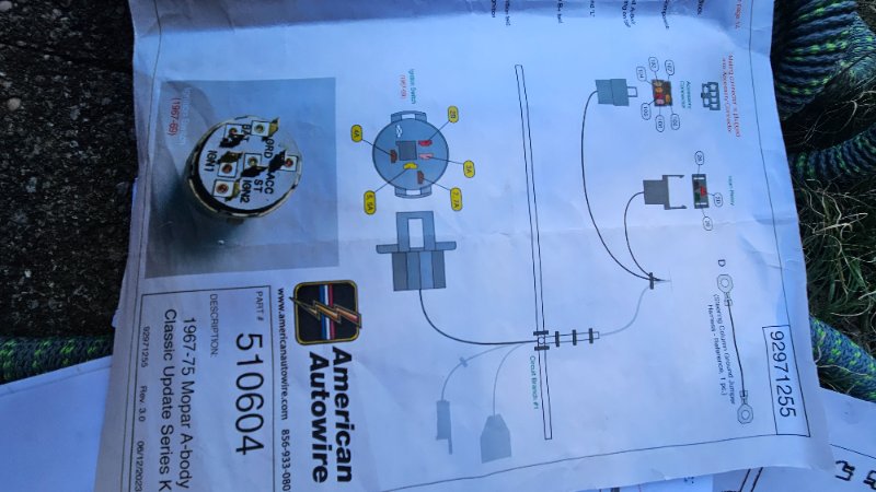

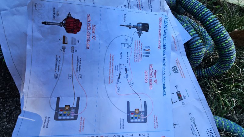

Still chasing this problem. I attached photos of the harness and the wiring. There are two brown wires and 2 pink wires. It won't even turn over now. She's definitely getting gas just not turning over. The harness instructions say connect the brown and pink together. One is ign1 and the other is ign 2
OK, look I do not understand what you have actually checked. Have you checked power AT THE ignition switch connector?
If so, do you have a bulkhead connector, or has that been eliminated. There is only so much that this can be.

The bulk head is there. It was initially hooked up to the 4 prong ballast resistor. I posted pics in the originally thread wouldn't let me attach them to this direct message chat. I messed with it today. It seemed like it wanted to turn over but wouldn't
So I used the test light the brown the two browns wires nothing lights up. There are two pink wires. When I test it they light up green. Meaning it's a ground not positive. The negative side of the coil is green and the positive side lights up green as well. This is driving me crazy. It will crank but no start
