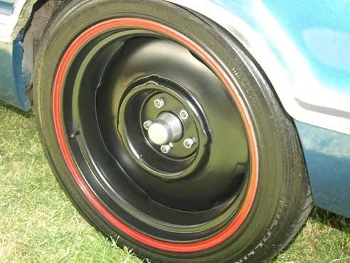

I've seen a lot of truck guys run small diameter tires on 15s and don't look right.
I love the look of Nice big side wall on a 15" rim personally but a larger diameter steel wheel with shorter sidewall can look good too ...
I'd be interested to see it either way but here is some short tire action. I think if you just went with a 16-17 rim with short sidewall but of classic design. Rallies, magnum 500, or steel wheels you would get a better look and handling car..

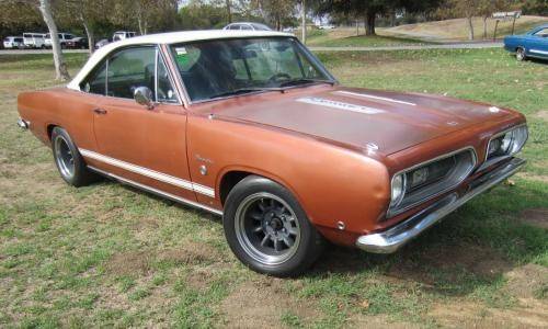

I ran those sticky 245/50-15s (24.6) on the front of my lowered 68S for 1 summer. THAT was a lotta fun. But the tires were done in a very, very short time. Several weeks at most.
How did it look? I dunno.I didn't care. I was having way too much fun to notice.
After that I installed 235/60-14s (25.1). They last a lil longer.The car sits about a qtr inch higher, no big deal. BFGs push a bit; and slide a lot. But I can steer with the gas pedal if I need to.

In my opinion if you lower the front it might be ok but these are 26's in the pics on 15's and I wouldn't want anything shorter on my car.
That rake look is deceiving too. It's the driveway. The car has no rake to speak of.
