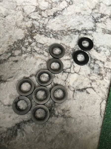

I came across this thread by doing a search. I had the same issue as the guys in the article. While installing head studs, I noticed the washer was spinning as well, so I sanded the washer with 60 grit and the washer no longer spins on the head as you tighten the nut. Thank you for posting.
