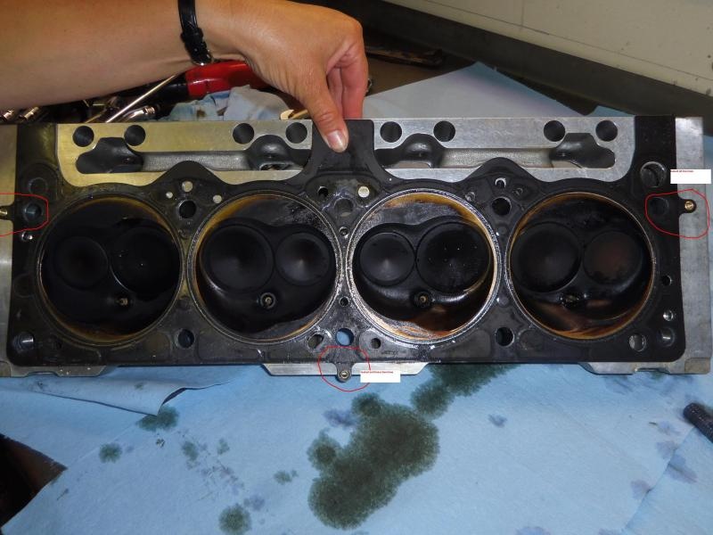

Poor design of gasket it also is pitting the heads. Only 14 miles on motor.
I cant see using them again.
they have a viton seal, so pitting would be from the leaks you were dealing with

I can't mock up a engineered problem, the gasket fit good and looked good. Can't do much more than that.

attachment.php
NO offense man - but you never ever expect an engine to fall together without issues. Engineered problem? when you have several manufacturers going into a build like this you have to expect to check every thing several times.
It did not fit good, hell it didnt even look good - that bottom one you could see during the mockup stage
you need to look around the head to see the rivet under the deck, but it's just part of the process. Things get missed, I understand that but you really cant blame that on an engineering problem.
I used the Mr. Gasket MLS gaskets and ran into the same issue. On mine, if I remember right one rivet would get pinched between the head and block but if you turned it around it fit good. But I did ruin one gasket. Then after running the car for half a season they started leaking. I'm back to the 1008. Why I tried the Mr. Gasket's I'll never know.

He is 100% correct. When you open the cometic head gaskets, there is instructions that say if any rivits hit the head or block then drill them out.

I just looked at my instructions and they do state that.

Well talked with cometic and was told I had wrong gaskets, but in 2010 when I bought them there was only one set to buy, now they have a set for the edelbrock head new part number is 5917-040 But i got the felpro 1008's on now. Hope someone got help from this.
If you put the gasket over a 340 block the rivets over hang but as you see not on the head still should not leak.
attachment.php
