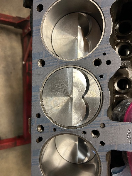

74’ 318 with .030” over bore.
Felpro 8553PT gaskets.
Machine shop gave me the felpro gasket set when I picked up the block. I started to assemble the long block and saw the fire ring is like 3/16” larger all the way around.
Worth buying proper sized gaskets or no issues and don’t worry? Personally I don not like the bore difference. But I may be over critical of it for no reason.

I've had great results with those gaskets. If you search for a smaller bore size (fire ring) the options are limited. 65
Cometic sells a bore size of 4.040 for head gaskets.
You could order custom gaskets, they make to order anyway.
They do stock a full top end gasket set with 3.93 bore size head gaskets included. I would personally not use the smaller bore gasket, but use the 4.040 gaskets available separately. Still pricey.
Seems like the 4.180 is huge difference, but Felpro lists those 8553PT as stock 318 gaskets. I am not a pro by any means, hopefully others will chime in. You may have no issue.
I too have had good results with them for stock or in this case mild cylinder compression increases.
I’m not sure how much that gap decreases compression. Or creates hot spots or burnout of the gasket.
I was hoping RRR would give his backwoods logic. lol!
I believe they are thicker than the 1008 like 0.054" compressed vs .039". Those numbers probably can vary a few thousands.
Send it. Thousands and thousands went out with those gaskets and it’s not an issue unless you are fighting for compression or you are trying to beat every last hp out of it.
Heck, the 1008 is 4.180 bore, and probably 90% of guys that use it( like me) run it on 4.08 bores, or smaller. So I would run it and not think twice about it.
Thanks! Just me over thinking it I guess.
I’ve run that gasket before with success. It’s only a van with 3.00 gears.
Ran into that on a /6. Milled the head and ("just") cleaned up the edge of a couple of a couple of combustion chambers on the head and laid a stock replacement fel pro gasket, a ROL and a Detroit brand gasket I have here on the head and the fire ring overhung the CC on the head but not on the block... I ended up with getting the Aussie HG as it had a bigger bore.
