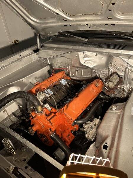

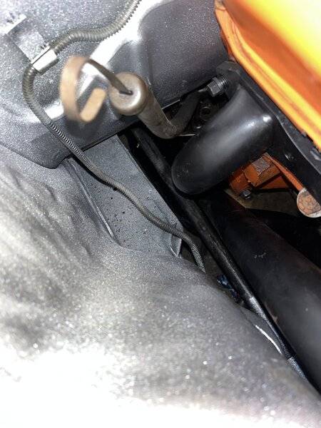

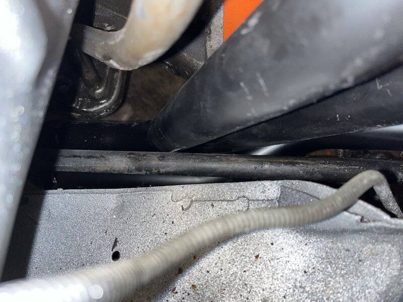

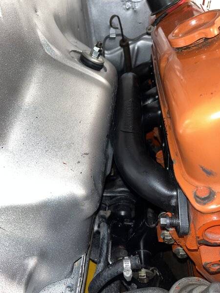

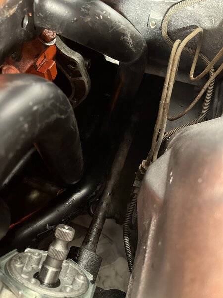

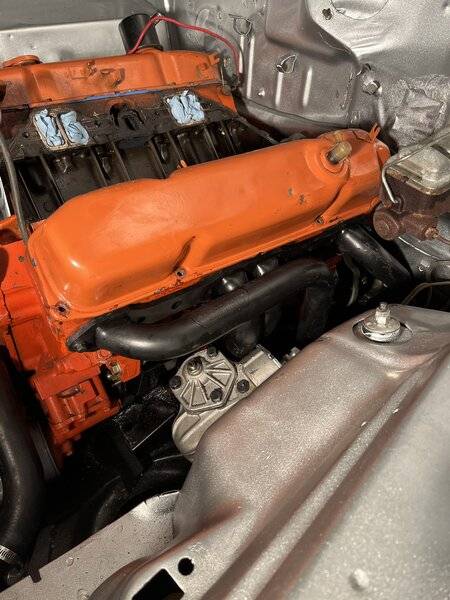

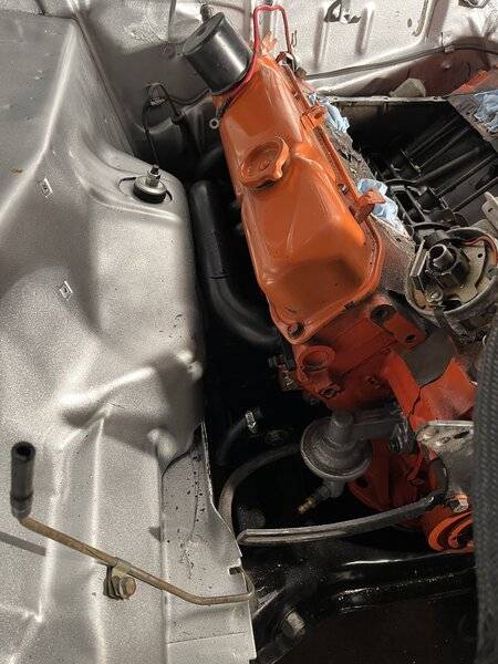

In case anyone is searching for this info, they fit. I’m thinking that dinging is going to be a car by car basis. Only way to find out is to test fit them. 74 swinger 383, Schumacher conversion mounts on stock slant six spool mount K frame, slant six bars. I thinking bigger t bars would guarantee more dinging.

Good job dude.
