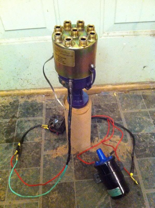

Here's the HEI system I put together for my cousin's Mazda RX7 (with a Mopar 318 engine)
Vintage Nippondenso 12 Volt Coil
4-Pin Accel HEI Module
Computer Heat Sink & Fan to keep the HEI module cool (heat is the big enemy of HEI modules)
70's Mopar SB Distributor (this would be a part you'd have to source new or used from another vehicle)
The coil is a Ford TRI coil. It has a fancy cover. It has a 0.5 Ohm primary, so it is used with an ignition with dwell control like HEI, or there is a ballast resistor.

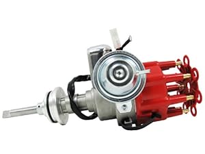

Here's the distributor. Points distributor with vacuum advance as far as I can tell. A ballast resistor came in a box of spare parts, but there isn't one currently wired up. Problem?

That is an HEI conversion distributor, and it'd be best to leave it.
(Explains the coil)
That is NOT a "points" distributor, I can tell by the "looks" of it. As Trailbeast says, it's one of those Chinese import HEI what is called a "ready to run" import distributors, it has a trigger wheel and control module all inside the distributor . As long as it works, it's probably OK. I don't think you can buy internal parts for those anywhere.
like this
There are various outfits selling these, ebay, etc. All Chinese, all the time, various quality, and various opinions as to how good they are. You can buy them as cheap as about 60 bucks
I
If you pop the chrome cover off the side of the distributor, you will find a "4-pin HEI module". No need to do so since you can find photos on-line. That is state of the art for distributor ignitions, and used by GM to 1995. Slightly better is the "8-pin HEI module", but only if you plan to have an engine controller managing spark timing (ex. Holley Commander 950). After that "distributor-less" ignitions started, but that requires a crankshaft sensor. I think those ready-to-run distributors all come from the same manufacturer in China (below). Most who have used them here like them. Most who don't haven't tried, hate Chinese products, rant, rant, ... I am glad they thought of us (except slant owners).
You should have a very strong spark with that setup, so set your spark gaps to ~0.050" for better combustion, power, and mileage. If you get misfires when accelerating hard from slow speed (like an on-ramp), back off on the gap.
