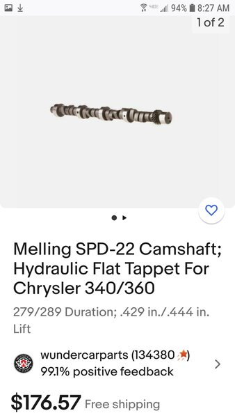

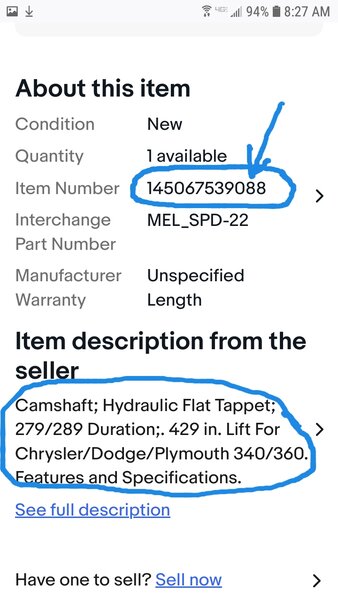

Here are the good Melling SPD-22 Camshafts.
Same grind as the famous mopar 340 cam. Have used them multiple times with geat success.
Performance and run nice too.
For sale on ebay and in stock too.
