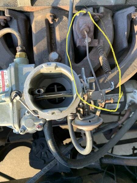

sketch Well-Known Member Joined Feb 12, 2021 Messages 83 Reaction score 14 Location Burleson, Texas Feb 19, 2021 #1 What is the part I circled ? What does it do? It keeps slipping out I need help I can’t foe the life of me find what this is
RustyRatRod I was born on a Monday. Not last Monday. FABO Gold Member Joined Jun 7, 2010 Messages 104,809 Reaction score 102,371 Location Georgia Feb 19, 2021 #2 Choke linkage. The Jesus clip is missing.
RustyRatRod I was born on a Monday. Not last Monday. FABO Gold Member Joined Jun 7, 2010 Messages 104,809 Reaction score 102,371 Location Georgia Feb 19, 2021 #3 Here's what the clip looks like. Don't go jumpin all over this one because I don't know if it's the right size or not. 1964-66 Pontiac GTO LeMans Tempest Carburetor Linkage Clip 66-67 Choke Rod Clip | eBay
T townsend Well-Known Member Joined Feb 8, 2021 Messages 461 Reaction score 359 Location 46601 Feb 20, 2021 #4 Most auto part stores stock or can order these clips. Just ask for dorman #41016. This is an assortment pack of choke rod clips.
sketch Well-Known Member Joined Feb 12, 2021 Messages 83 Reaction score 14 Location Burleson, Texas Feb 20, 2021 #5 thanks guys. so new at this. now for the bonus question; there is only one screw on this carb for the fuel/air mix, right? is it yellow?
Mattax Just the facts, ma'am FABO Gold Member Joined Feb 7, 2013 Messages 17,794 Reaction score 14,790 Location Phila. Pa Mar 1, 2021 #6 The screw in your last photo is for adjusting the fast idle speed. Service manual will you help alot. MyMopar - Mopar Forums & Information - Service Manuals Originals are available used and reprints are sold by various companies. Bishko is one. A lot of very good information is in Master Technician Service Conference - Chrysler's Training for Mechanics 1966 222 and 1970 273 are two on how carburetors work. Others get into specific mechanical adjsutments. If some of the info is complicated then come back to it. The 1969 master techs are also in The 1970 Hamtramck Registry Library Page (1965 - 1969) which has lots of factory and dealer info. Some of which you and your son may also find interesting.
