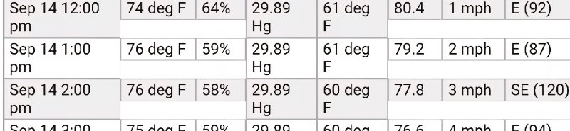

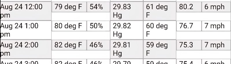

Same track August 24th and Sept 14. Car exactly the same. 60s 1.55s to spinning 1.8s but usually the car will mph at about 135. For whatever reason it went 137.5 twice. So best mph this weekend was 134.5.
3 mph vs 7 mph. I dont recall it being windy. Here's some info from the 24th

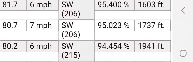

Here's a snip from the app for racetrack DA which shows all the numbers at the Orlando track at this moment.
