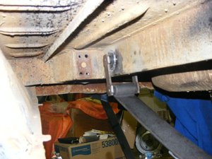

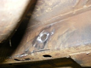

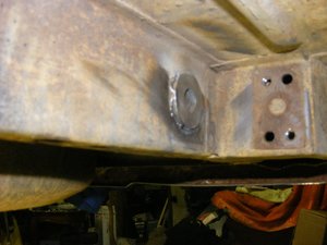

1 inch tube for bushings.Enlarge hole to 1 inch,tac the tube and add a big washer for extra support.Looky here..

Bushings fit nice and snug!:cheers:

If you plan on using S/S springs you may have to move the passenger side hole forward about an inch. Depends on how the shackle is sitting once the car is on the ground. I had to do this to 2 different cars
