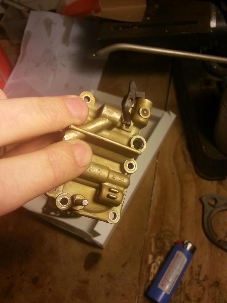

Can I put this in the cleaning solution?

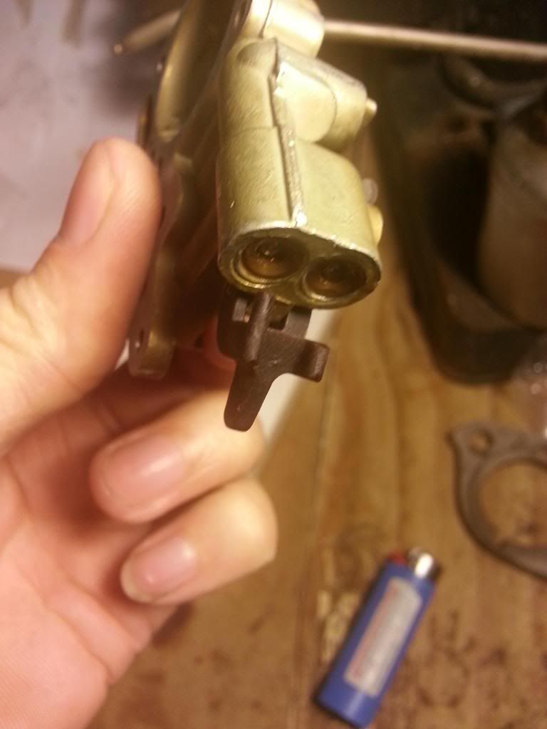

Where can I get this piece? I'm pretty sure its broke. Was like that when I took it all apart... FML. The plastic brown thing....
I took it off by gently spreading the ears and popping it off the pins. I was worried that it would be brittle, but it wasn't. Same thing for putting it back on. I may have one of those nylon thingies on a core carb; yours for the postage if you pm me an address.
If this is like the one on my 390 Holley, I think they are nylon of some kind.
I hope this gets taken care of soon, I know you are moving forward and need this soon.

Out of the carb and on its way to you. Those little buggers make me nervous; always think they are going to break, but haven't busted one yet. Tougher than they look. I wonder what broke yours? Maybe the ball check stuck?

Looks like a Holley 1920 metering block. That is the part that you can't easily dissasemble and probably gets fouled, and why so many bad rebuilt ones are in the pipeline. I recall some posts on how to reverse blow the air ports to clean them.
The brown lever is part of the "economizer", as I recall. I think it actually serves to enrich the mixture at higher speeds, similar to the "power valve" in the bigger 4 bbl Holley's. It is activated by a vacuum piston. Your's has a 2-step enrichment normally, but only 1 step with the broken finger. I don't think it would be active at idle so probably doesn't explain your problem, which I expect is a "too lean" idle where it slows way down and shakes when you shift to D. That plagued me for decades thru several 1920's until I got a good one.

I had the same problem with my Holley; one of the fingers broke off so I used another carb for parts and put it back together. I also bought a new float because mine was saturated. I'm pretty sure the float made the difference in the way it ran (which was good).

Exactly what I needed thank you! Your a life saver.
