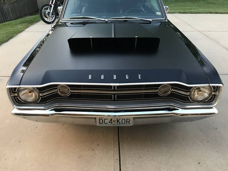

How about this one? @mopowers the flange isn't visible at all unless you're looking into the scoop? The flange had hardware set into the fiberglass. I just set the scoop where I wanted it, marked where the bolts were and then drilled the holes. Easy peasey
So, the bolts were fiberglassed into the flange. That does make it easy.
