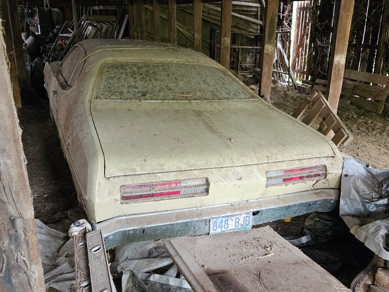

Been too long. Thought I was going to get it out 10 years ago... life happens.
This was my best friends grandmother's car. According to her son she drove it to church and the liquor store. That was it. It has 48,800 original miles...and change.
It is a 1972 Duster. It has the original reptile pattern top. It is the very common tan color, top is kind of greenish taupe of some sort...it should all clean up real nice.
Slant six, really nice car. Has had some rust repair on a quarter and the tail light panel. My dad bought it from my friends dad, he drove it for a bit. It started to run a bit too warm so dad parked it and intended to fix it. That was several decades ago. Dad passed away a year and a half ago.
Plan is to get it out and running. Move it to our other barn with all the other vehicles. Fix the rust with some new panels, tail light and quarters. Paint on just the repairs to match original paint and then just drive it.

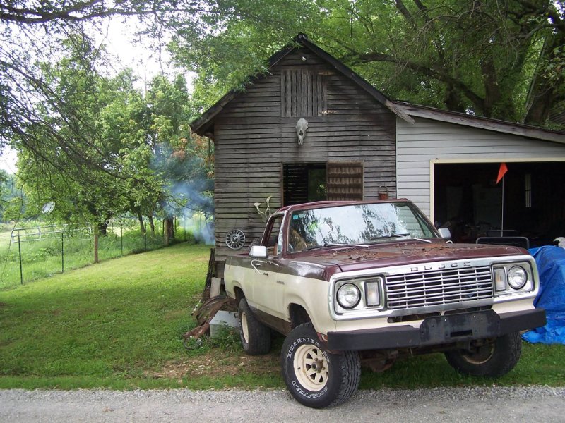

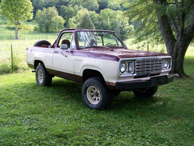

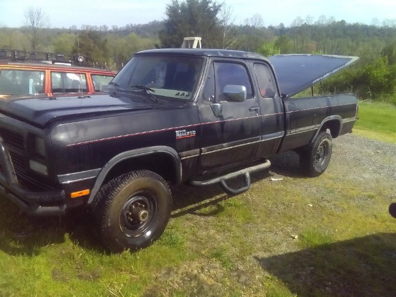

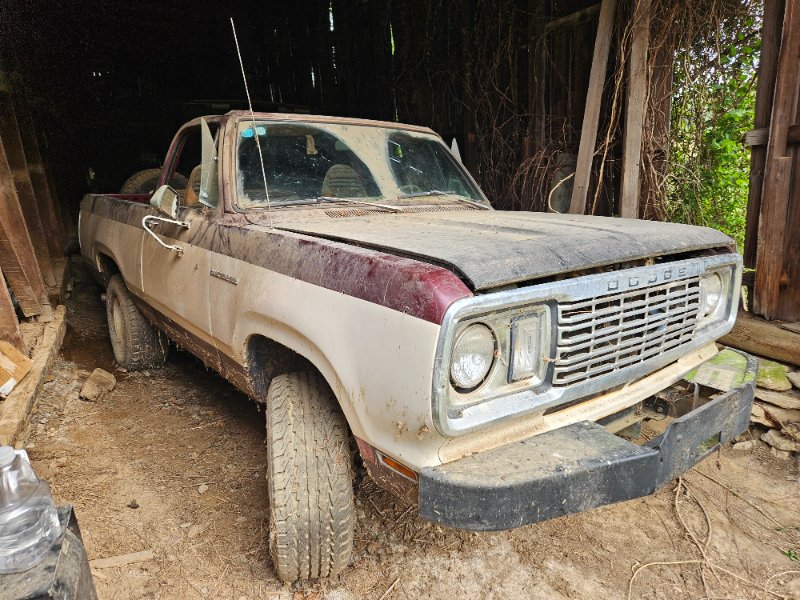

We also just pulled out dads 1993 1st gen club cab cummins diesel 4 speed. My 1978 Ramcharger as well. The Cummins runs great, needs the Killer dowel pin replaced. Ramcharger I am currently putting a new fuel pump and new fuel line and filter.
This is my Ramcharger I recently pulled out. Very solid Ramcharger, very little rust. It came from Guatemala, gauges are in kilometers. Has Guatamalan stickers from past service. A veterinarian sticker, found Guatemalan coins in it when I first cleaned it out years ago.

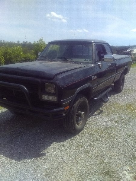

Here is the Cummins dad bought new. Just over 100,000 miles. Real nice truck. 4 speed Getrag.
He was quite the collector. Mostly Power Wagons, M37s etc. He hauled many home with this truck. This was just after we pulled it out and gave it a quick hosing off.

It has already been cut and bondo and paint on those panels once years ago. Just the tail light panel and the lower quarter. Before we had it. Only repair on it. I cant remember if it was for rust or minor accident.
I prefer original cars and old patina but you can see the bondo popping off on the right tail light in the one photo if you look close. Also popping off on the lower quarter panel. If you dont repair at least those and repair them correctly then they just keep eating metal... it would be left all original otherwise and new tail light panel as this one is a lot of bondo and some sort of caulk like material around tail lights with paint over the caulking.
Totally understand, and in that case I would repair the old repairs.

I have a '93 D250 Cummins Club Cab w/295K miles. Great truck. Had Cummins "Serviced" at Cummins Ocala just before I bought it, so I need to call them with serial #s to see if they did the timing cover death pin update.
Yours in all black, including grill is a great looking truck.
Presently finishing up rear brake job. Had to put Speedi-Sleeve on left side, so I had to make a 3" pvc driver to install it.
Needs rear trans bushing and seal, and driveshaft carrier bearing. It's never had the bearing mount shim update done.
(7/16 thick spacer to drop bearing down), and its worn bearing and bushing and maybe slider spline.
