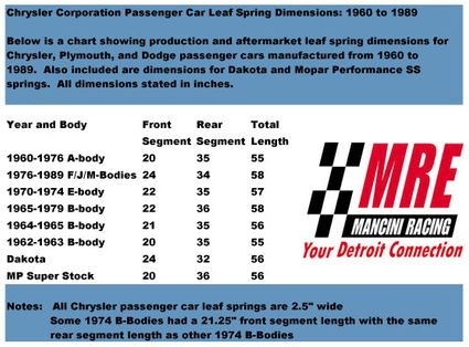

One more thing Classic doesn't know: The A body springs also fit a 62 B body. They have a 20 inch front segment, same as A bodies. That's what my brother put in his 62 Polara 500 convertible. 63 and 64 B bodies have a 21 inch front segment and neither A body nor later B body rear springs fit.
Finally, I'll second the reports that Eaton springs are really high quality but really expensive. With shipping and installation kit (u bolts and shackles), we're talking about almost $1,000.
