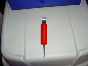

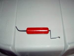

I have a tool that does a good job on the mouldings, it is a KD tool for Chrysler window mouldings. I will post the number/photo as soon as I get a chance. Made short work of the mouldings on my wife's 68, and other projects. MUCH easier to use than the tool you are looking at.
Here are a couple of pictures of the moulding tool I use. I have 2, sometimes t helps to work the clip from both sides.
The handle has K-D NO 2037 on it.
