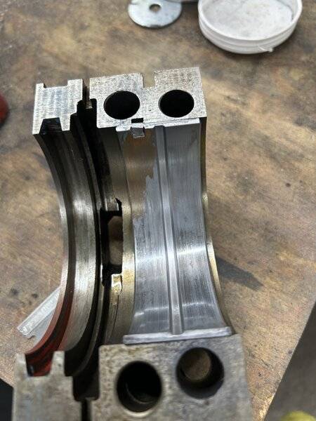

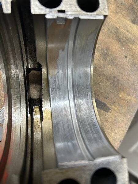

While replacing the main seal on my engine, I took a look at the bearing on the rear cap and wanted some opinions on it .
yeah, too much copper for my liking. Be curious what the thrust bearing looks like.. But, I'm sure plenty look like that and are still on the road :)
I also noticed the oil pump drive has a lot of play in it. It wobbles quite a bit when I move the hex end . Engine is upright on stand with cam and intermediate shaft still in place . Might need a new bushing .
I’m against the masses here and think it looks ok to me. Had a little trash go through it at one point but the coating wearing off is pretty normal. For 30k it looks normal.

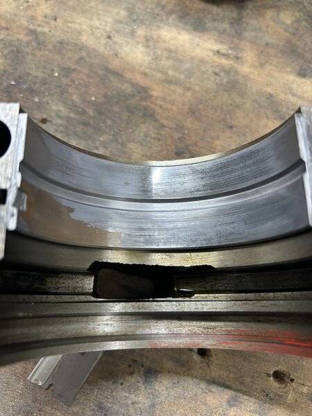

What seems odd to me is that the bearing cap is the same gold-ish brown color as that one edge of the bearing. Does that mean that part of the bearing isn't making contact with the main journal?
I thought about that . Can’t remember if I had it line honed
Looks like the crank bearing insert is doing its job.
Softer material protecting the the more intricate crankshaft.
What's with what looks like chatter marks on the block to main mating surface? Is it walking?
