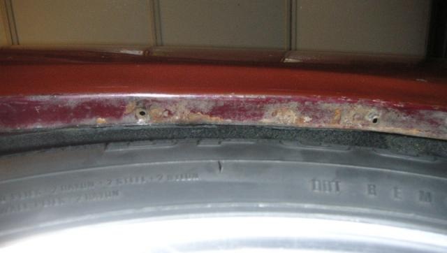

I know there are a lot of ways to do this. What is a good way to roll the rear fenders?
Should I tape the lip, then cut about an 1/2" off. Then use a body hammer to roll the lips on the flat section. Or is it best just to hammer the whole lip over?
You'll have a hard time just rolling the whole quarter lip. Remember that the quarter lip is doubled up, it's the quarter and also the wheel tub, and those are spot welded together for the entire lip. The spot welds are about a 1/2" in from the edge. What I would do is located the spot welds, then trim the lip down to the edge of the spot welds (so the tub and the quarter stay attached), and then fold the lip over from there. You'll need to use a hammer and dolly to keep from distorting the quarters.

I just need to roll the flat section above the tire. Left side fit the tire, the right is into the tire.

They roll fenders just fine, you can develop enough force to actually push the whole fender out. Rolling the lip is no problem. The non-round wheel openings mean you have to adjust the length of the arm as you go, but it's easy.
The quarter lips in the back would be more difficult, the doubled up layers and spot welds between the quarter skin and outer wheel house would make life a lot harder. I think you'd have to do some prep work on the quarter seam to make it easier to roll before using that style of roller. Totally doable, you just might have to start the bending with a hammer and dolly and then smooth it out with the roller.
