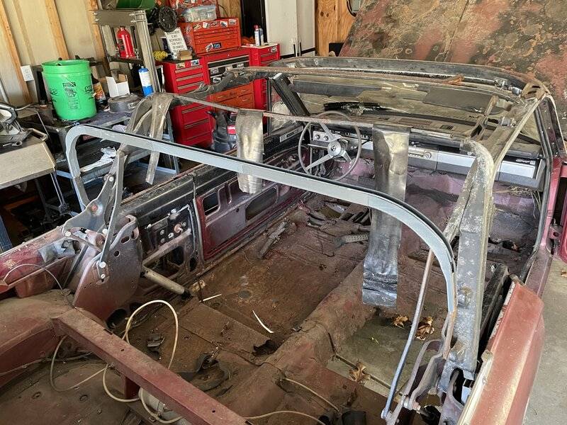

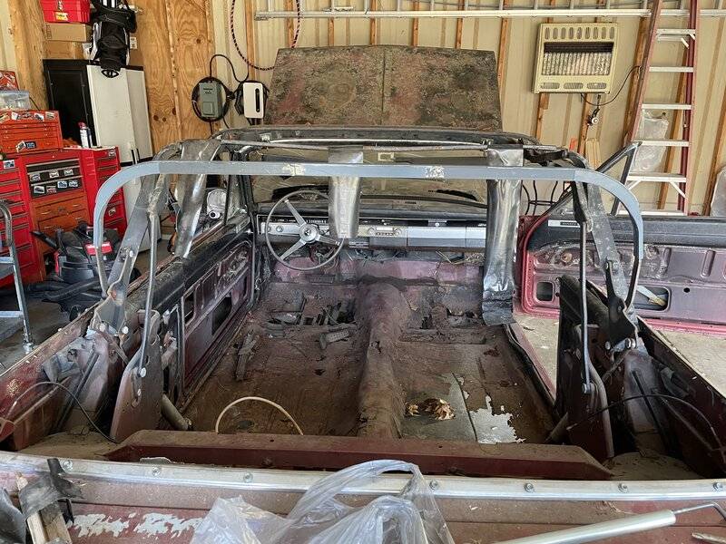

How would you bend this frame back?
Sistering means attaching a flat piece to another piece.
In woodworking, if you had a floor joist that was rotten or had too many holes in it you would put another joist right next to it and attach the two together.
If you had the correct shape you could cut it out of a flat piece of 18 gauge plate steel and have it welded to the existing bow forcing the existing bow back into shape.
One of you photos looks like the bow is cracked where it is bent. Doesn't look like it could be streightned easily.
Most likely the top will have to be removed from the bow to make a repair.
And yes there is some material in the bow that the top can be stapled to, mine (67 dart) has a hard board like material

Take that bow off and take to good blacksmith or fab shop, they could make a new corner piece to match the good corner then replace the bad corner. My brother in SD would enjoy doing it, especially for a Mopar.
Kern Dog offered a spare frame bow he has. That is starting to look like the way to go
That would be the way to go. A good top shop MAY be able to replace it without removing the top. (Key word is MAY)
If the offer doesn't work out with Kern Dog, I'd love to talk to your brother!

Somewhere in this car's life, a heavy politician must have sat on the top frame while doing the parade wave. The frame bow closest to the rear window looks bent.
I'm wondering if the fix is to remove the rear bow and lay it on my bench top. Trace the drivers side, flip the frame over, and try to strong arm the bent - passenger side back to match the tracing of the driver's side. Assuming the driver's side is the proper shape...
Yes/No?
check & make sure you havent had an adjustment bolt slide before you bend anything
Thanks Rodney. It's definitely kinked. I did pull the two set screws, thinking I could pull the damaged part without risk of destroying the old canvas top. No confidence in that happening!
There is enough other stuff to do, I figure I'll wait until the top is toast to pursue it further...
