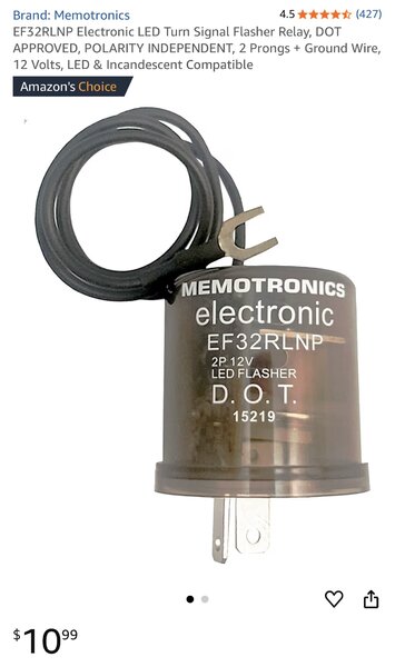

I have replaced all the blinkers, tail lights and dash lights with bright LEDs in my 65 Plymouth Valiant Signet convertible. I have also put the correct flasher in so everything blinks at the correct pace. But that green blinker ON indicator no longer works and I do know why. There is not enough current going through the bidirectional LED in there to make it flash. I even tried an original incandescant too but no luck. Has anyone else dealt with this upgrade issue and made the indicator flash? I'd rather not go back to the less bright halogens or incandescents. Thanks for any help.
