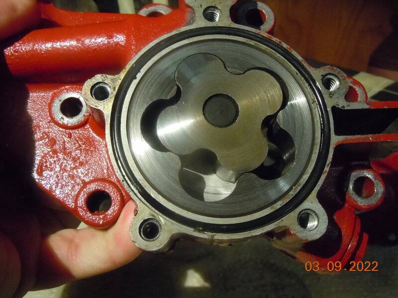

Slant oil pump volume is determined by the thickness of the rotor.
There are three thicknesses of the rotor.
Thinnest the oe mechanical lifters is approximately 5/8 inch.
I believe this is what I have, the rotor measures about .650 or so.
Post a picture of the oil pump. I can tell if it's HV or not.
RRR, here you go with the cover in place, and the cover removed.
Is the pump body aluminum?
Yes it is.
Did you service - clean the oil by pass valve in the oil pump as part of the re build. The by pass valve should move freely and the FSM has a spec on spring length.
Oil pump rebuild kits with new inner and outer rotors and gaskets show up from time to time on e bay. Pay attention to get the correct rotor thickness.
I did a complete inspection on the pump when I built the engine, and all was in spec. I'll do it again while it's apart. The spring length was also in spec at that time.

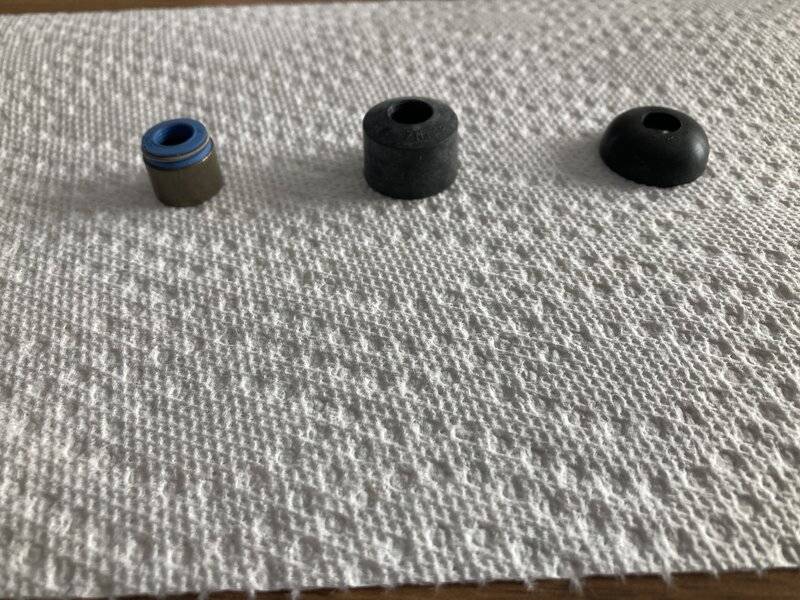

Photo of valve guide seals
Left: Positive valve stem seal
Center: example of the 'Premium valve stem seal' included with a NOS FEL PRO full engine gasket set. Unfortunately, the packet does not have a part number on them. In my spare parts stash I did find a packet of the same style valve stem seals from Victor Reinz, part number B45623.
Right: Umbrella valve stem seal
also on the subject of stem seals, I believe that Killer6 is correct in post #174 that the 'improved stem seals' were used in the mid 70's and that there are modern positive stem seals that will fit a mopar 1/2 inch guild.
concerning oil pumps my FSM has the rotor thickness limits listed below
1968 Mechanical valve trail pump rotor .649 minimum
1983 Hydraulic valve train pump rotor .825 minimum
the use of the word 'coking' is used to describe the residue that remains on an engine component when engine oil has severe oxidation and breaks down.
Since the intake valves in your motor have a black residue on the stem side it is a good assumption that the valve stem seals are leaking. The leak shows on the intake side as that side sees a vacuum and will pull oil in. The exhaust side maybe just as bad but that side sees pressure and will push oil out.
The leak may be causes by defective seals, or worn - out of round valve guide ID's, or worn - out of round valve stems, or a combination of all three.
Here's the final update on this thread, then it's back to business on the truck build thread. I did indeed have coking on the valves. I took the head back into the machine shop to get positive seals installed, it should be back next week. They also noted it was running wildly pig rich, which I agree with. I'm going to downsize the carb to a freshly rebuilt Holley 390, and I got a wideband sensor so I can see what's up with the tune. Between bad timing, running too rich, and what-all else, this go-round should turn out better.

What carburetor was on it? Oh and that is a totally stock oil pump. Not an aftermarket replacement. It's a good one, though.
It was an Edelbrock 500 AVS2.
Good to hear about the oil pump. It is totally in spec and going back on the engine.
