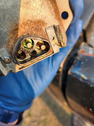

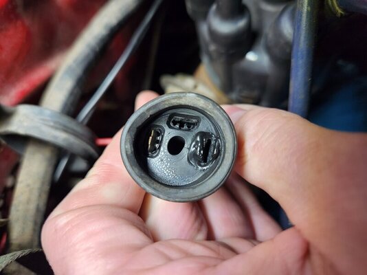

Only other question is this. Does the voltage regulator connections look a little worse for wear? There's a sticky substance which I assume is the tar you can see on the backside leaking through maybe? It was sticky enough to make it chore to get the plug off and it broken the raised plastic bit that plugs the Dark Blue wire into the regulator so now I'm waiting on two pigtails and another fusible link to try again. Will update the post when I can confirm or deny this was my issue.

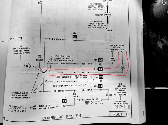

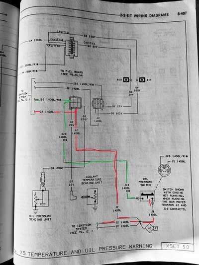

After inspecting under the dash for broken connections and coming up short I went back to wiring diagram and noticed the ignition switch runs through the Oil Pressure Gauge pigtail which reminded me I had tried to move it out of the way when tightening the distributor the first reinstall.
The top of the oil pressure sender is the gage wire connection.
I'm guessing that the three prong is a safety switch for electric choke or other stuff. I would not think it would be the J1 (power feed to switch) but a branch of the J2 (Run) circuit.
So take taillight harness and put it inline where the fusible link that's problematic or right off of the battery?
Tail lights are usually always hot.
Traditionally they get power from the 'always hot' portion of the fusebox.
Your issue is in the J1 feed to the ignition switch. That's what you need to investigate, and where you might want to use a bulb to limit the power through (and light up when there is current flowing) or a breaker that will pop at 10 or 15 amps.
The 3 prong does tie into the choke as well but is involved in the ignition circuit using the dark blue wire that is split throughout more of the ignition system. The idea is that the light turns on with the key on and once started it stays on until the opposite prong of the two gives a reading to say there is proper oil pressure and thus the light goes out. Since the plug is semi hard to find I am just going to put the gauge sending unit right into the block and bypass the dummy light while I wait for another one to show up.
J2 circuit is engine run (usually blue insulated). Traditionally it powers everything critical to running the engine, which includes powering the alternator rotor (aka field).
So that's a branch of the J2.
Typically if there is no pressure gage, then a lamp is used to light up when the pressure is low.
The question is why was there heat generated in the connection.
If its split as you describe, then one terminal out is to the choke - that's somewhat high current, and the other lead is to the indicator bulb, and that should be low current when its on. Be worth looking for shorts.
I see here the choke control. Was it shorted or drawing too much current?

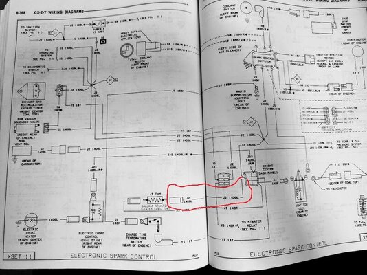

Coil connections
Your magnum changes the final leg connecting to the coil positive from Blue to Brown and labels it J3.
(That change color coding goes back to the early 70s)
Regardless, its branch off of the run circuit supplying power.
It (coil positive) measured 14 Volts, assuming the alternator was producing at 14 volts, that's fine.
The coil negative connects to a switch inside the ECU, or points, or in your case the HEI.
In addition to switching on/off, the HEI controls the current flow through that wire.
maybe one of the HEI users can describe that more and how it might appear on a voltmeter measurement.

Currently the only thing I have started to work on and dive into is the Oil Pressure Switch. Oh, and the Voltage regulator only because I ruined the plug when undoing it to do the above "test". I apologize to all if it seems like I'm ignoring all of the information I've been provided as that hasn't been my intention.
I want to resolve the oil pressure switch to either a) be done with this newfound gremlin or b) move on to test other things using the info provided. My ADD brain sees the melted switch that I caused during the swap and admittedly I really hope it's the problem, but that's what I hyper-focused on once I realized it was a mess. This is the diagram that I am seeing to make me believe that at the very least the oil pressure switch is a problem, if not the whole problem. Thank you again to all of the help so far.
Just a quick update that it appears my issue stemmed from the poorly connected/bent oil pressure switch. Fusible link has been replaced with new link wire and so far so good after running the car everyday since fixing the link and bypassing the switch.
