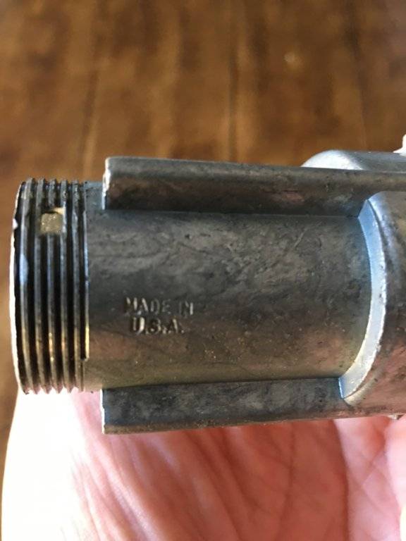

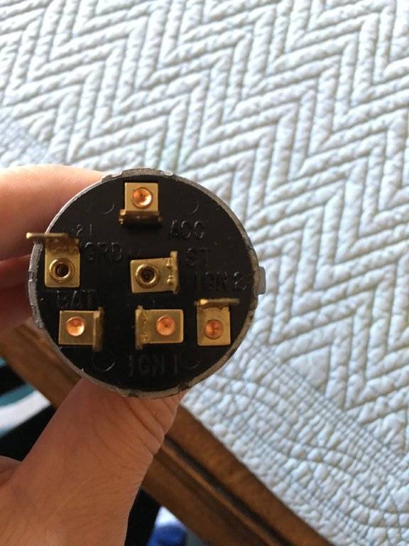

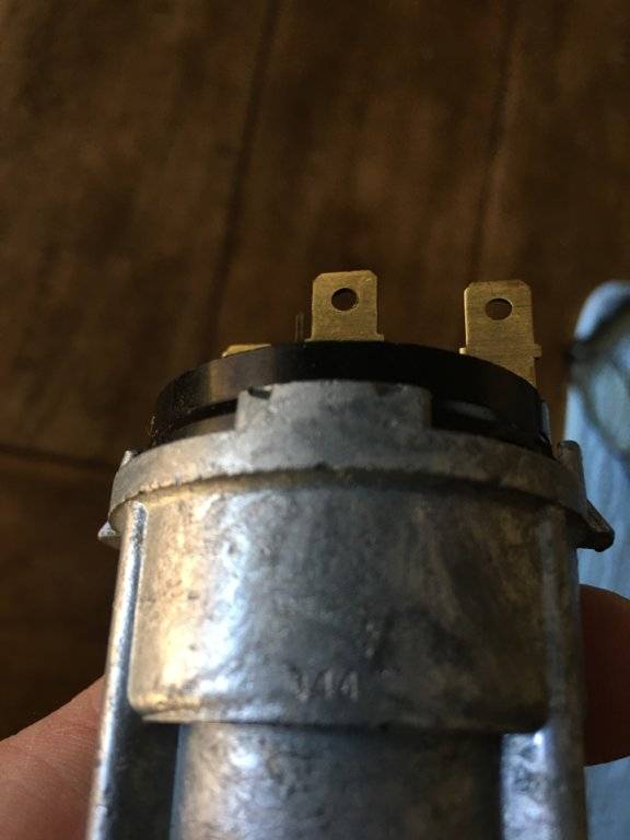

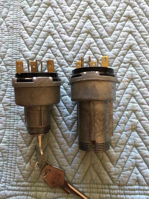

Since I’m the OP on the other thread I thought I would post a side by side of the two... the one on the right is supposed to be for a 69’ or at least that’s what I paid for AGAIN! Lol the other remaining pics are of the 69 switch only
I have one of those chrome bezels in really nice shape if someone needs one. May be NOS....
The one in the first 2 pics.. I guess its for a 67. It was in a box of NOS crap I've had for decades. I have a switch for it as well.
Just my two cents, The 67 has a chrome bezel, The 68 has a painted bezel and the 69 has no bezel. All installed this way in the several cars I have stripped. The 69 ignition switch is a different size than 67/68.
