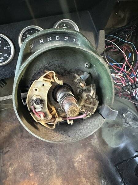

I'm doing HotRod Dragweek and a horn is required. Younger me took the horn stuff out of the column and now older me needs it. Stupid then yes, further discussion about it needed, nope. So what all parts am I missing to get the horn working? 1972 Demon in case it matters.
I know I need the horn button for sure.

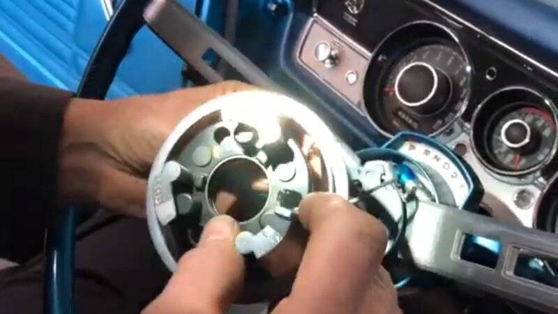

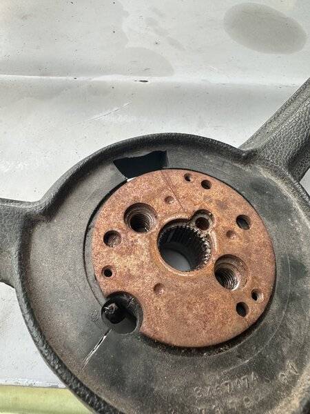

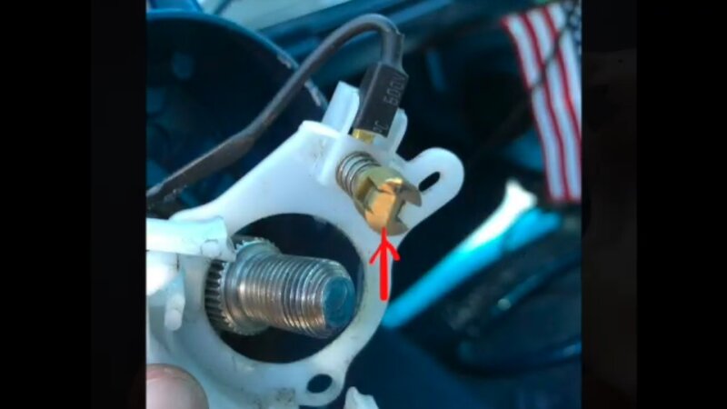

I just need pics of the parts I need, I'm not looking for debate, opinions of what you would do or lawfare. Just pics of a complete assembly or somewhere to find a pic of said assembly

The roller is still on the T/S switch... Try grounding it & see if the horn honks... If so you just need to fix the wire coming from the contact ring on the back of the steering wheel and the switch parts...
If it doesn't the horn/horns and/or relay is probably missing... Easy fix...
Like all the horns I run across, if they haven't honked in 30 years the wire probably won't help.
The relay is missing too. Younger me decided it was too much weight.
