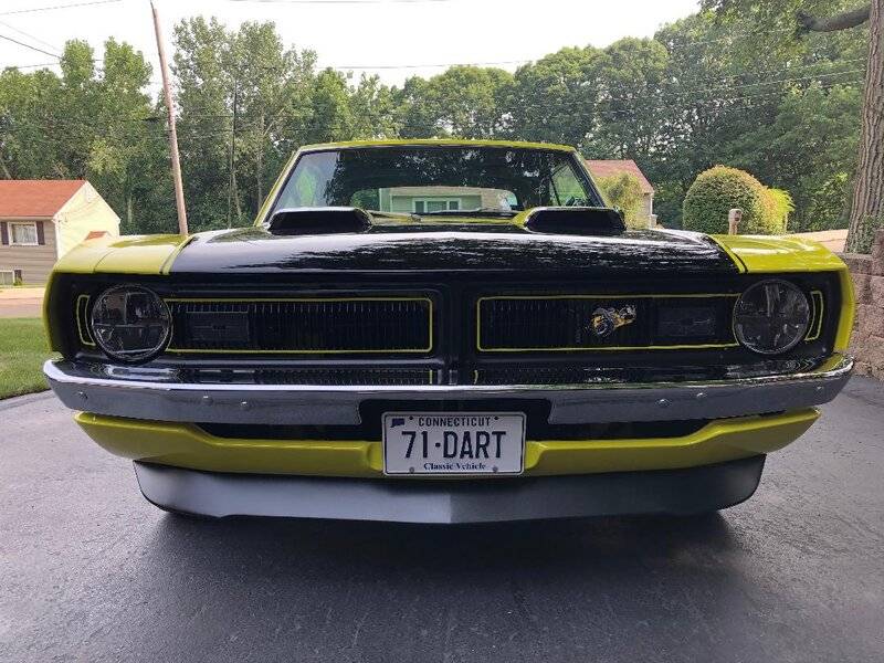

Got this 340 hood with the scoops, bezels, and 340 call outs on the scoops, going on my 70 (after refurbishing)
Thanks Derrick
you going to drill the 4 1/8" holes (think they are) too? i've yet to do mine. i have the rubber pieces to go in and all. just haven't gotten around to drilling yet..
Same here Joe. I've got everything except the hole saw and the nerve to drill into a perfectly good hood!

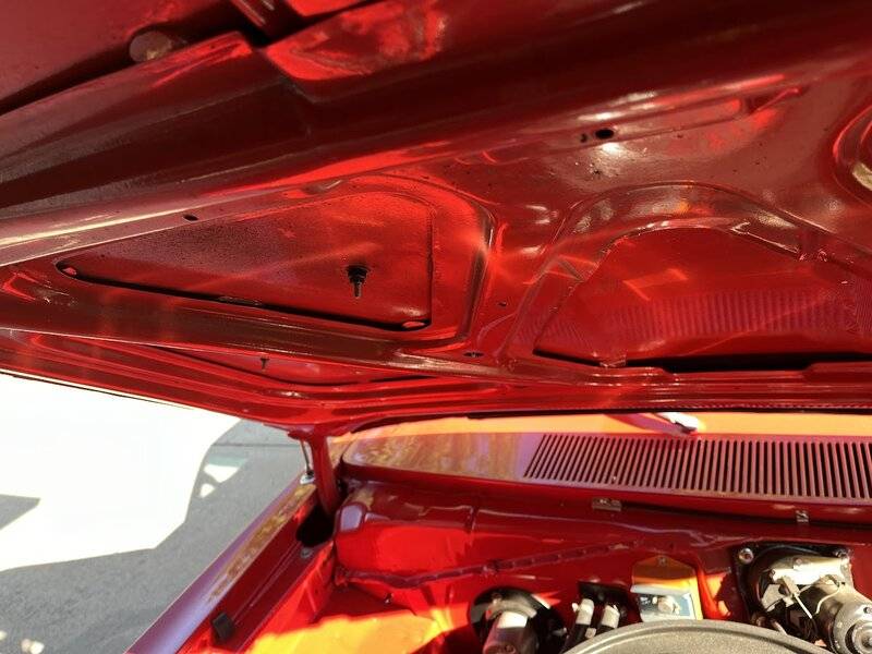

Just a heads up/FYI, a past owner bolted the scoops to my hood without putting the holes in. This has created two problems for future owner me.
The scoops have some broken studs because they are constantly trying to be ripped off of the hood. Also, the hood has come loose from it's bracing and is extremely wavy. I'm looking for a nice flat hood and may put my scooped hood on the wall of my garage.

Here's a pic where you can see the glue between the braces and the hood is broken loose
It's probably the previous owner over tightening the studs or the hood flex causing the studs to break. Those scoops just don't catch enough air to break those studs and if they did catch of ton of air, it'd rip the studs from the air scoop first.

Most of the Hoods without scoops look like that too Brian. That Seam Sealer in-between dries up on all of them.The studs also break when they get really old. I'm sure it's better to have the holes to relieve the pressure

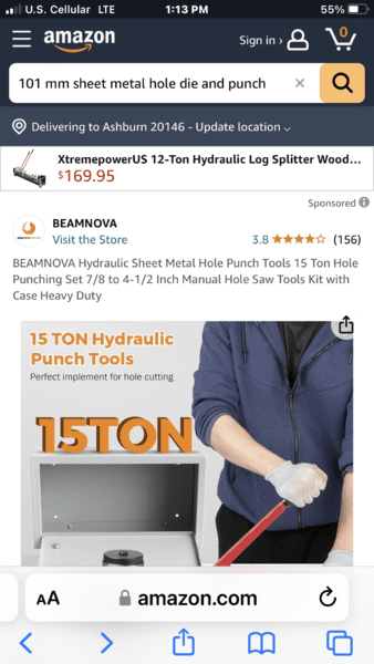

I was thinking if I did, I would have it laser cut, yeah I know, $$
Care to elaborate?
Do what OMM told you to do. Use a 4” die and punch. I have used them before, but at the 2” diameter. It cuts a clean hole, quickly, way cleaner than having it lazer cut and there is virtually no heat involved. You just drill a hole center location and mount die on the underside of hood with threaded rod through the hole. Mount die on top of hood through threaded rod, thread and hand tighten nut. Then drive the die. Won’t even mark up a fresh paint job.
Care to elaborate?
You risk the saw walking a bit if you don't hit it perfectly square through the entire cut. Even a small amount of pressure may leave deflection in the hood. Mine was cut with a die for those reasons. I've used hole saws on thin metal many times. Most turn out well, some not so much. Not willing to take that chance on the hood. Just my opinion.

Anyone have a good idea what to use to fix ? Seam sealer ?
RTV sticks better and lasts longer instead of seam sealer.
If your hood surface lifted off the old putty it will just do it again.
RTV and a little weight where it lifted will work really well.
