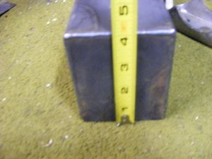

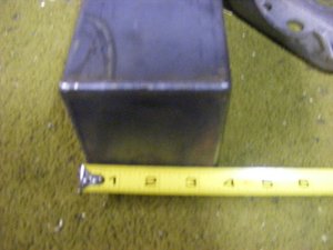

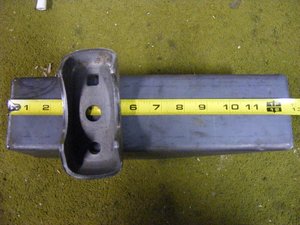

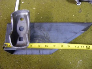

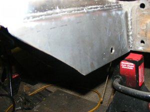

Here you go,ya lazy bum!LOL
These measurements are of a Mopar kit!

O.k,so it looks like they could be fabbed from 4x4 box tube.
