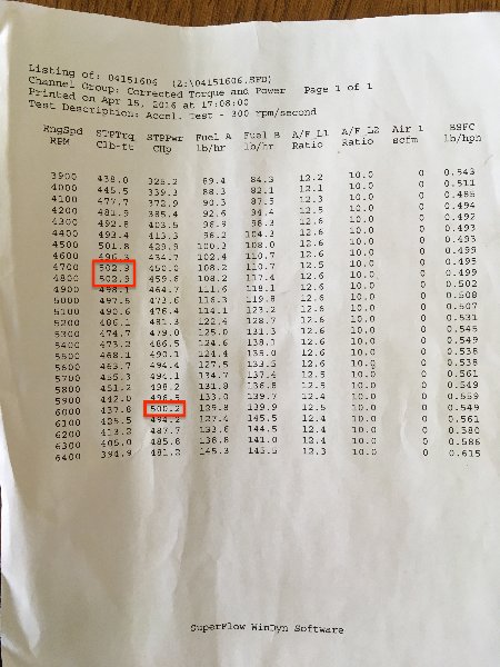

They are good heads. Mine were CNC ported by Brian/IMM out on California so they are certianly more capable than a non-ported set. They flow 293cfm on the intake. He didn't really touch the exhaust though if that tells you anything. Very heavy though!
On the previous iteration of my 416" they made 500 hp @ 6,000 rpm. The torque curve was flat from 4,000-6,000 and never went below 440lb ft. (See the dyno sheet below) There were a couple things holding the overall combo back but either way it would have been a pretty stout street/strip combo. Diamond dished pistons for 10.3:1 compression, 251/259 @ .050" solid cam, 1 5/8 step headers, gasket matched Holley Strip Dominator intake, OOTB Proform 850 carb.

My dyno sheet from 2016.
